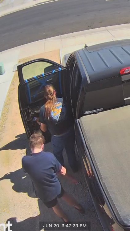

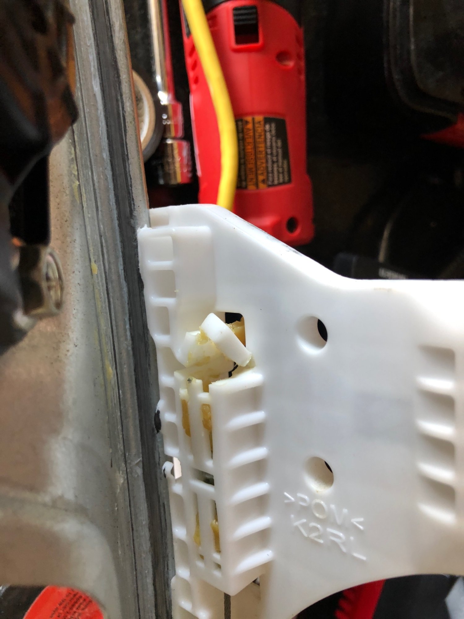

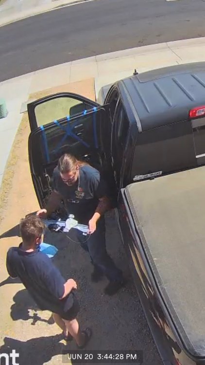

Cable on the Window Regulator snapped.  🤬
Out with the old (took about 10 minutes to finagle it out of the door, showing my son what happened to it):
Point of failure:
In with the new (went in with no problem):
Cleaning off the grease on the window (Hard to keep fingers out of the grease when manhandling them):
