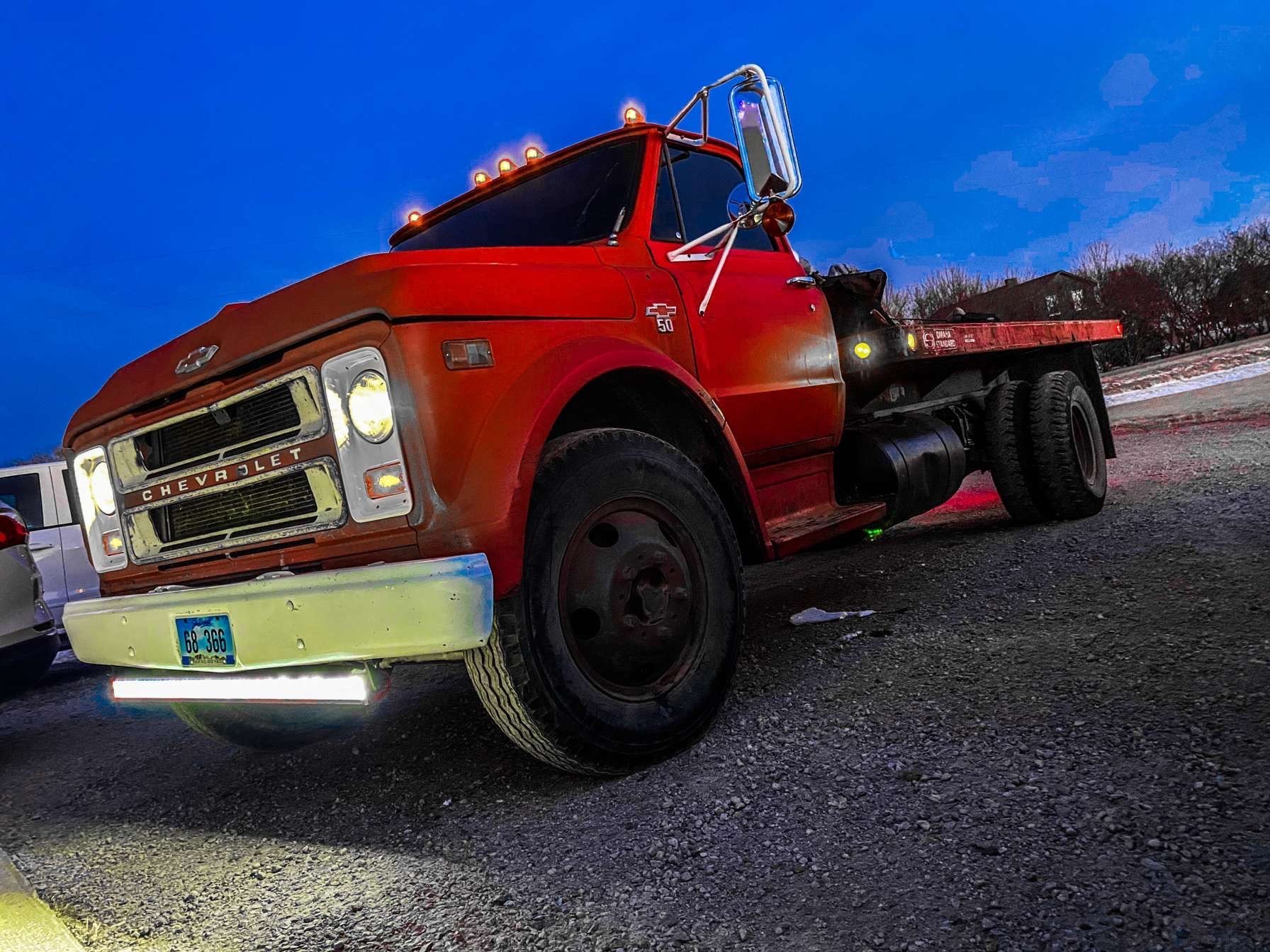

Evening everyone. I am looking for input on a build I am going to be starting. I have a 1968 Chevy C50. I am going to be dropping the cab onto a 3/4 ton pickup frame and going to be going with a twin turbo build. I am trying to source the best block setup for this. I will be going for a high horsepower fuel injected build. Haven't decided on a transmission yet. Any advice or pointers are appreciated. Thanks
