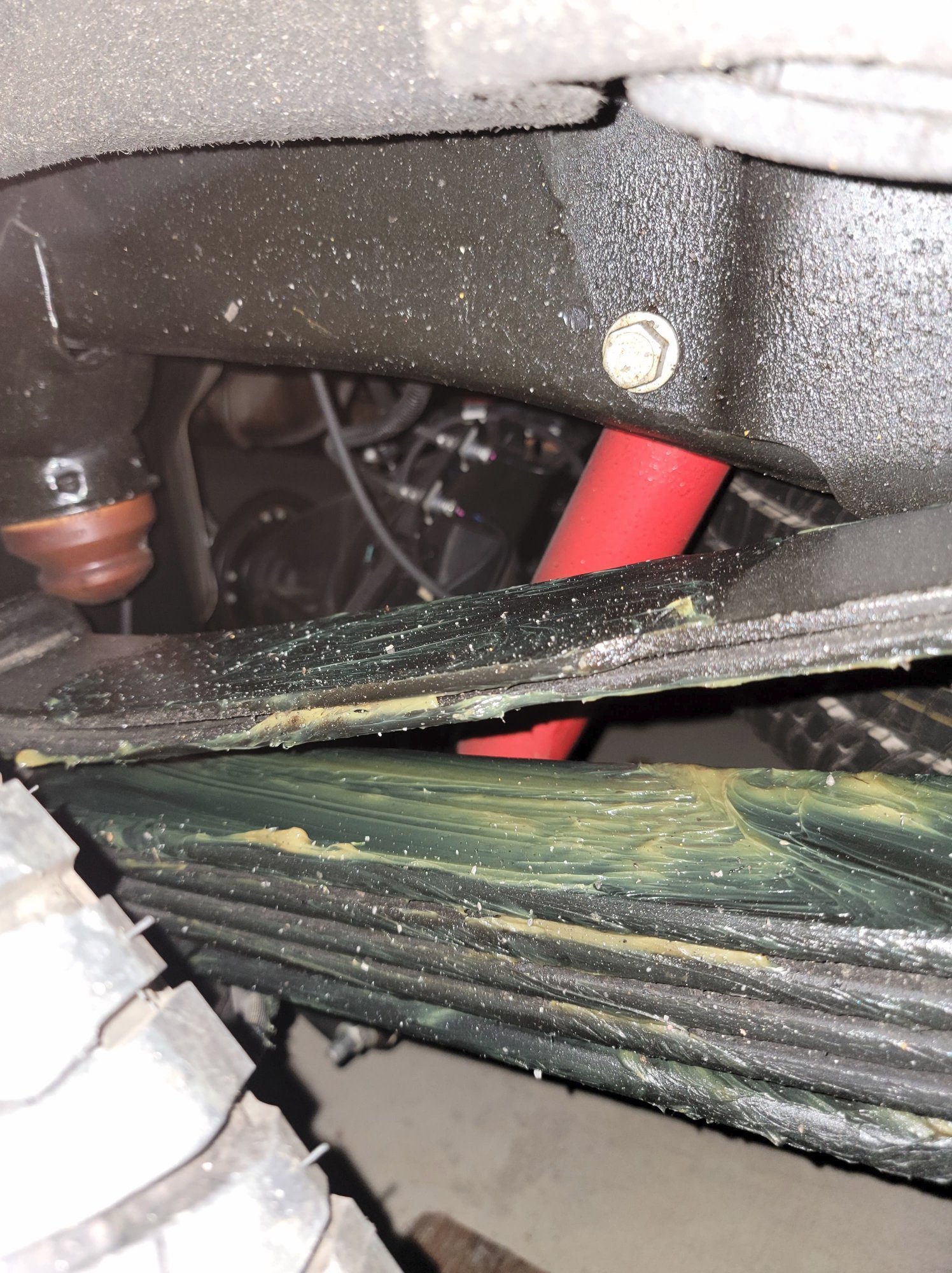

this is what the dealer did to my 2022,  made no change and i think worse at times,  thurs its going back to get all of it cleaned off,  the specs are small stones stuck in the wheel bearing grease
Edited by leolkfrm
this is garbage.
the service department and the tech who did this should be ashamed of themselves
just got back from the dealer,  gm, new spring packs ordered, but per gm tech no guarantee that it will fix it or that the issue will not return.
