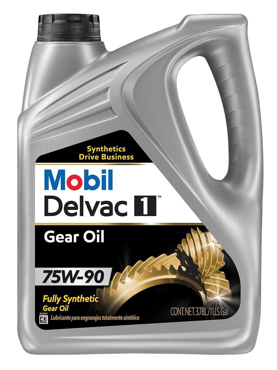

Mobil1 Delvac gear oil does not contain LS additive. I used 75w90 Delvac when I changed my diff oil.
