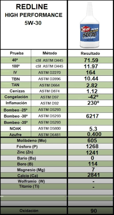

21 hours ago, VicFirth said:
Noack: 5.3%
Oxidation: 90
My bread and butter go to for years.
