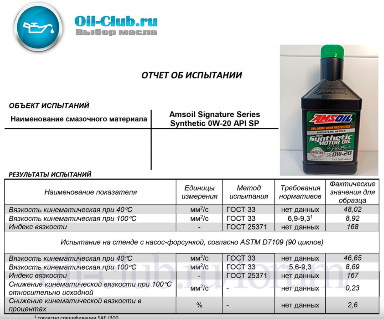

Stole this from Bobistheoilguy.
Amsoil subjected to the Kurth Orbahn shear stability test.  Excellent results after 90 cycles.  Viscosity loss of only 2.6% after 90 cycles.
Edited by VicFirth
