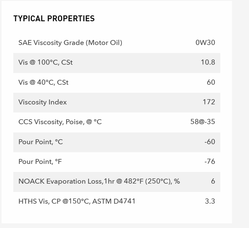

About a year or so ago Red Line reformulated their 0w20 and 0w30 grades to be LSPI friendly.  Essentially they went to your Mg and Calcium combo rather than high calcium.  Noack is extremely good across the Red Line grades.
They have the 0w20 Noack at 5%, which seems too good to be true.
0W20_MO_PROD_INFO_2023-2.pdf (redlineoil.com)
0W30_MO_PROD_INFO_2023.pdf (redlineoil.com)

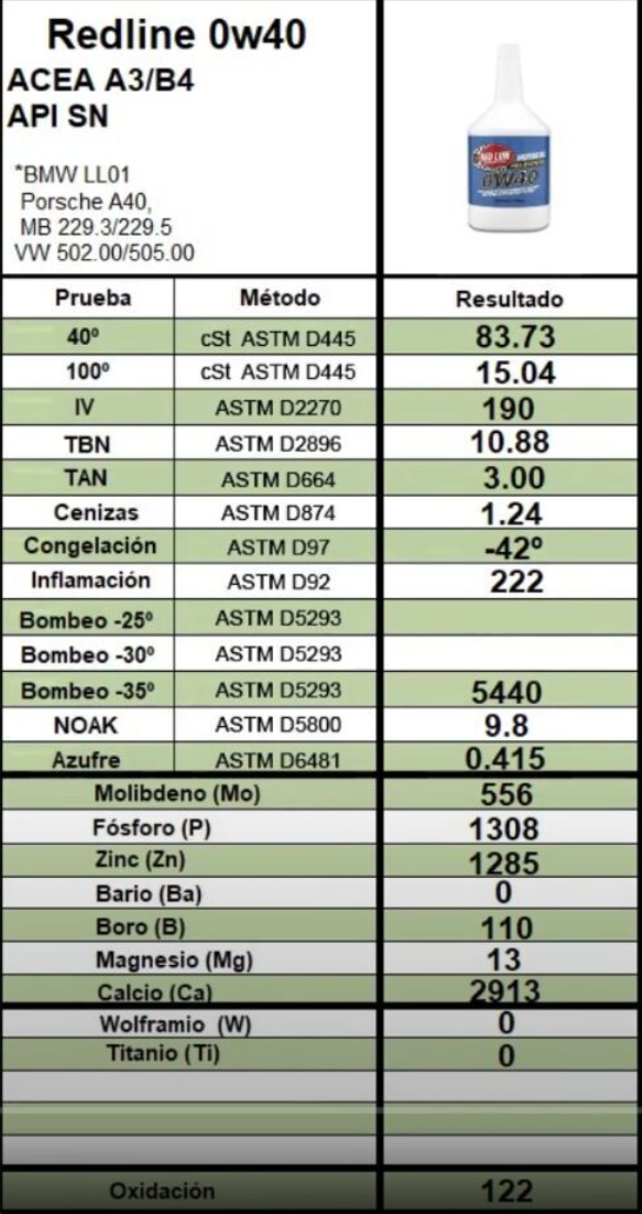

Look at the virgin oxidation value of Red Line 0w40.  122.  It's said though that the oxidation value can tell you the presence of an ester, but you can't quantify how much.  There does seem to be a correlation though.
I think AN's are a better base stock though the more I read about them.  Or combination of POE and AN.
It's a very strong correlation. Strong enough to hang your hat on. Now that said it is not indicative of the formulations Aniline Point. A better measure of solvency. AN's will not show as oxidation but will really suppress the Aniline Point.
