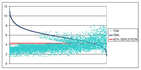

For starters, he tries to make a point that the crossover point is based on the PH of aqueous solutions thus has no bearing on that of mineral solutions. Problem with this is that corrosion is an issue of excess hydrogen ions, corrosion, or deficient hydrogen ions, caustic embrittlement. While aqueous v mineral base sounds line apples and oranges excess H+ is plain old excess H+.  Rubbish. Secondly the actual acids ARE aqueous. Nitric and Sulfuric acids from the dissociation of Sulfur and Nitric combustion byproducts with ever present water of both oil and fuel.
That he claims the test is "notoriously' has poor Unrepeatability and reproducibility. They extrapolated that with an assumption the bias is ALWAY in the same direction for all cases (2), which is not true. But his point on that is not without merit. It's just that most of that 'random' results are NULLIFIED by using the 50% rule. Crossover is more generous yet. 60% percent is dangerous. Copper corrosion test to 4A or greater are destructive. Also dampened by ISO standards and the human element is smaller than suggested.
And yet folks it is an acceptable ASTM method used to produce this showing increase wear metal actually BEFORE the cross over point:
Shortly before making this claim, he ADMITS at about 2 minutes into the video that this method "Gives a large Safety Margin" Hum....like that is a bad thing. It's a great thing!
Then he makes a statement that there "Isn't a test for the depletion of the corrosion inhibitor". Also, not true. What he should have said is, "There is not DIRECT" measurement of the depletion of corrosion inhibitor." Does that sound like I'm splitting hairs? Any idea how much science is done by indirect measurement? Like theoretical physics! The graph above is an example of indirect measurement of that very ask. To explain....
He suggested that we plot (TAN V TBN) V Copper (or Iron) PPM wear metals. And find the point where the copper wear metals increase 'happens' v the TBN/TAN relationship. That kids is called "DISTRUCTIVE TESTING" and assumes that there is an ACCEPTABLE level of damage to be endured with EVERY oil change interval to extract the absolute maximum value from you OIL dollar. When in reality the idea is to extract the maximum value from the power trains LIFE.
He further suggests you run copper corrosion test to find YOUR limit of acceptable destruction. Really? 😏
My limit is zero IF it can be avoided. 50% depletion is just entering the TAN 'troublesome" range. I'm good with 1a/1/a 3 and 24 hour.
