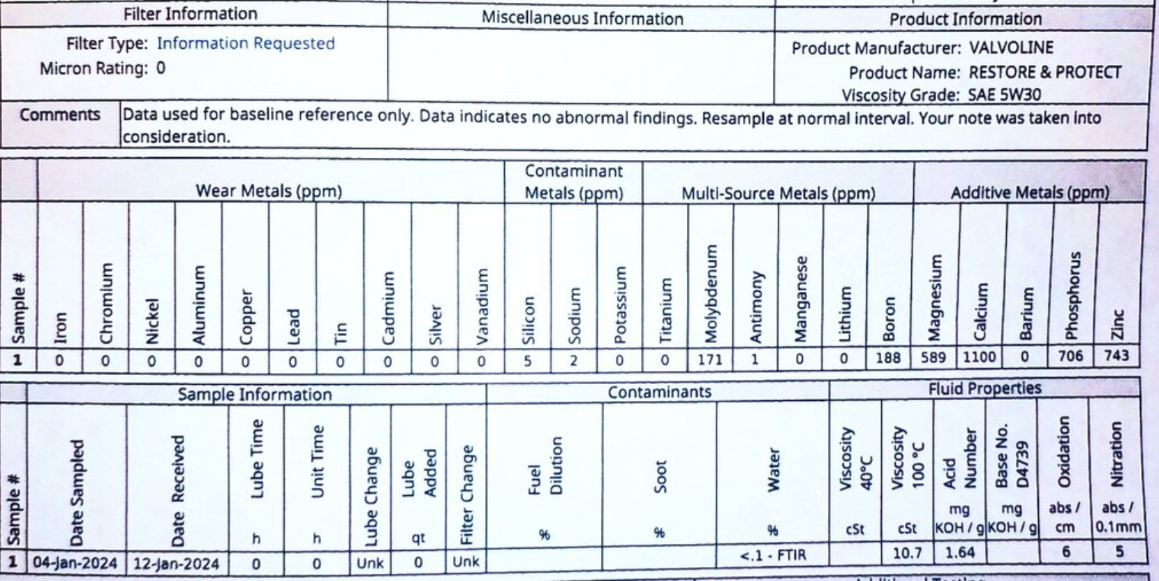

Well it looks a lot different than the Premium Blue Restore, which was PAO/V and had an oxidation value of 110.
Here is a VOA of the new Restore & Protect.

Cannot believe there wasn't a TBN run on this. Always a job done half. Well, such as it is....
Any cleaning is not coming from polar products. Mid SN/SP phos levels. 😬.  Good boron hit. Moderate moly.  Initial viscosity tells me why it isn't 'energy conserving". I like that number. Not a bottom feeding eco oil. I might be surprised but the TBN couldn't be very high. 7 or 8 maybe using the weaker acid value.
Smell tells me there is something "different' about this oil. Cleaning is chemical and not polar. Well, we have a base line. Good! Thanks.
I think the guy asked for both TBN and TAN so he's going to contact the lab for it.  I agree it seems like they're likely using an additive rather than polar base oil to achieve the results they are claiming.

Share it if you get it, please.

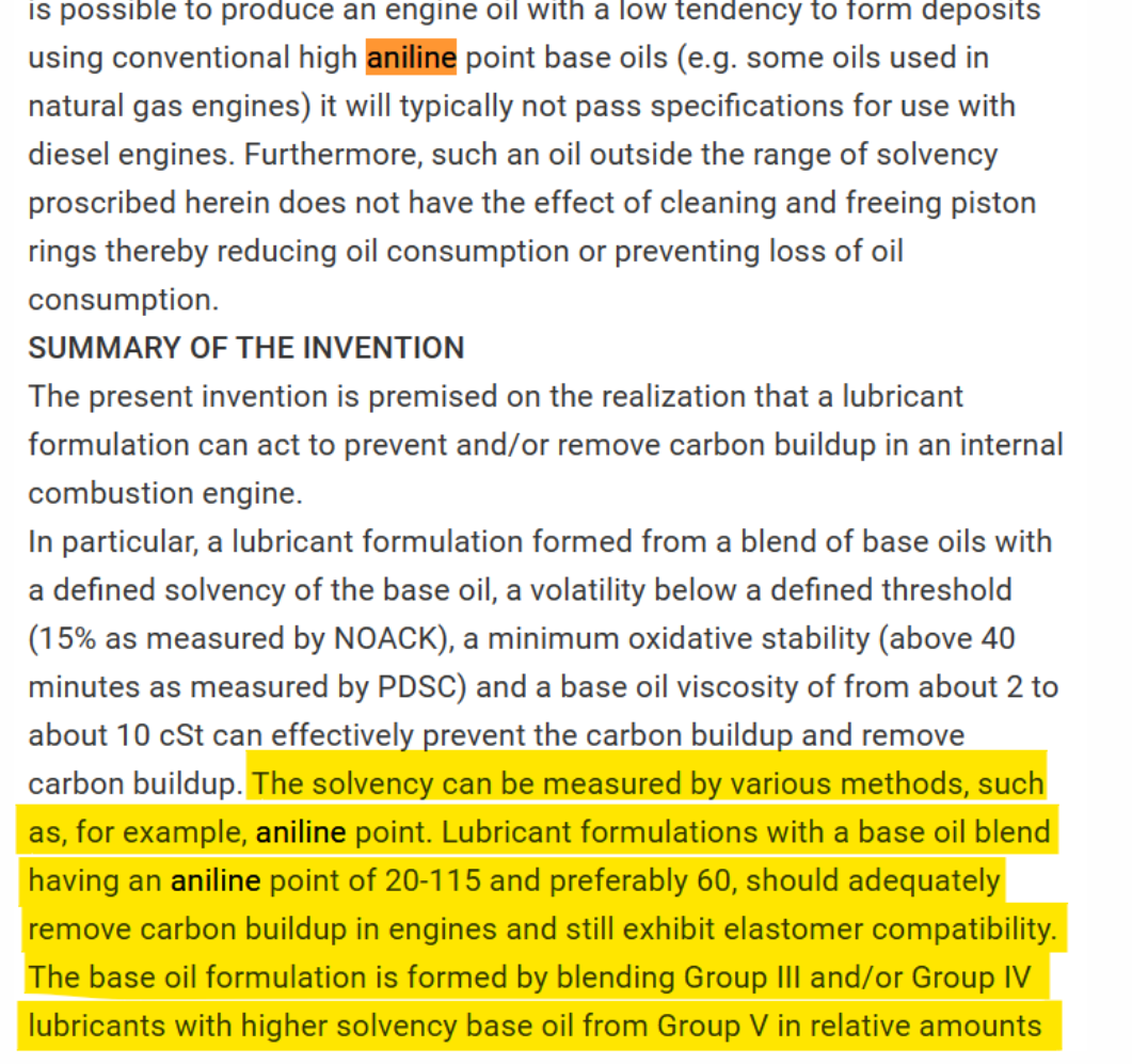

This patent basically validates how HPL/RL/Amsoil SS can clean and keep engines clean.  My guess is Valvoline had to find a cheaper way to achieve this because the base oils required to do so would push the price up beyond what any of the cheapskates at Walmart would be willing to pay.
US20170029734A1 - Lubricant for preventing and removing carbon deposits in internal combustion engines - Google Patents

Thank you Vic.
Anyone remember my discussing running aniline points on finished oils? How about the effect of polar components influence on OXIDATION values? Estimating the ester level via oxidation? The need to have a background OXIDATION value to judge the UOA value against? The importance and ability of polarity on/of cleanliness? Charts perhaps of the aniline points of various possible base stocks. Ever see me put this chart up?

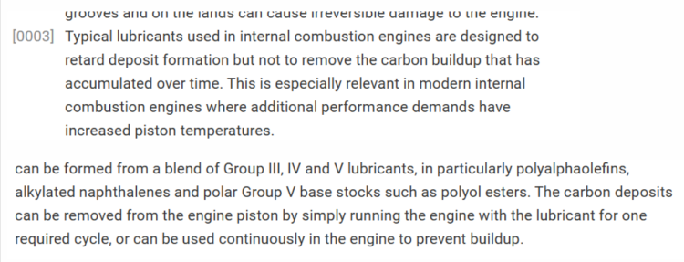

This was a most interesting from the Valvoline Patent:
[The carbon deposits can be removed from the engine piston by simply running the engine with the lubricant for one required cycle or can be used continuously in the engine to prevent buildup.]
CUMMINS Valvoline Blue Restore (no longer available) had a VOA oxidation of 141. Closest one I've seen to this is Red Line HP running between 90 and 120 grade dependent.
