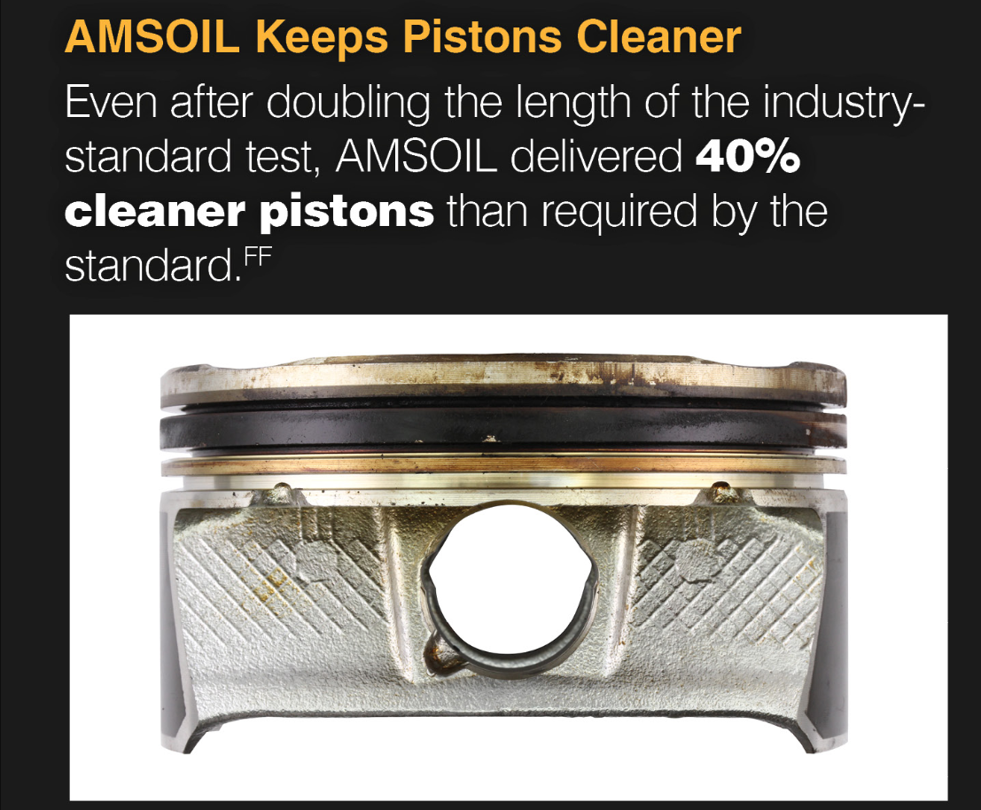

I've been interested in this question.  From the reading I've done, it appears that oils using even the most high-end base oils like esters and AN's will "run clean" but not always necessarily clean.  Maybe AN's can clean per King Industries literature.
Here is a piston shot from Amsoil SS after a double Sequence IIIH run (180 hours @ 304F).  This is on the preventative side.
Edited by VicFirth
