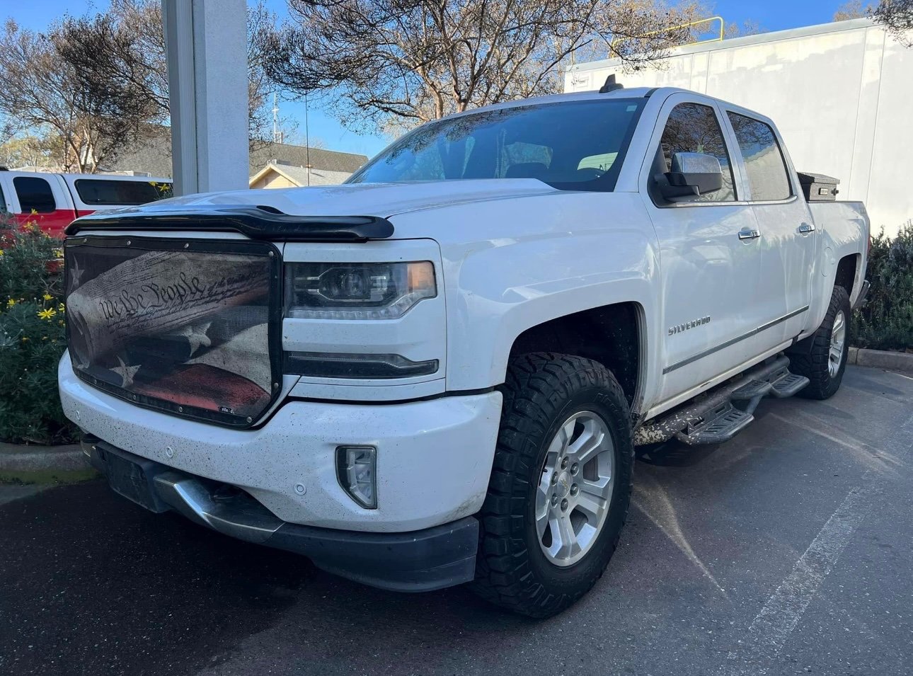

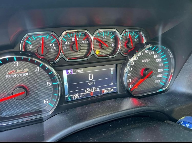

Saw this pop up on another site. 2016 5.3. 404k miles, original engine. Amazing things happen when you change your oil more than recommended.IMG_6738.thumb.jpeg.44acf7fbe6b58d5407775f34befda03f.jpegIMG_6737.thumb.jpeg.c14827538abc981839b590542656ee19.jpeg
You can also change your oil too often, which can cause a spike in wear during the seating phase.
It is the general nature of wear and not actually tied to then number of oil changes. That spike happens regardless. It's height and breadth can be and is influenced by many factors, but to frequent, isn't one of them.
Title (mahle.com)
  • Thanks 1
I don’t know the guy, but supposedly it is done every 4k, which is probably like once a month at the rate he runs. Not excessive but more frequent than GM calls for. I’m sure the highway miles help a lot too. But it’s still impressive for any motor let alone one with AFM and all the other stuff people say is faulty, bad metallurgy, etc.
