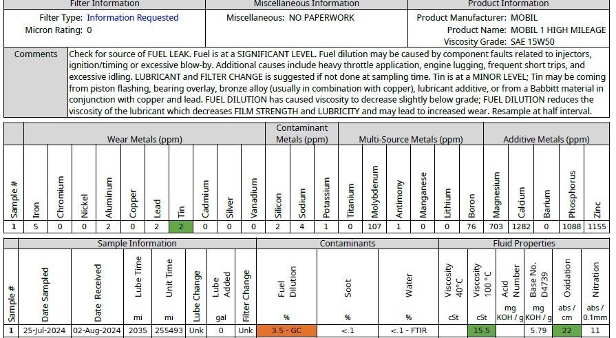

Dizzy!
The OEM calls for a 5W30 Dexos1Gen2 oil. Energy conserving. Meaning low HTHS viscosity. 2.9 cP.
She uses oil so there is blowby and that keeps the fuel dilution off zero but at 3.5% there is another issue and I'm calling it the High-Pressure Fuel Pump seal.... again.   The trims are LOW and canceling each other smartly, trending zero. Does that eliminate an injector? No, but it does cast a large shadow on it. The rings have been done in this motor for a few years now and over 100K miles. So, we have some history to work with. Zero trims, success getting too near zero with just the pump replacement even with the ring issues. Let's try that again. Only sooner this time and not get distracted with a 1 Abs unit of Nitration and a laundry list of 'what if'.  Could I be wrong. Sure, but that isn't the direction of this post.
The direction is VISCOSITY. I chose this 15W50 not so much to slow the consumption but to PROTECT the motor from just this type of issue. Fact is, if the cylinder is polished this oil would make it worse.
The result of 3.5% fuel dilution is a reduction in viscosity. At least that is what the notes say. But there is another player here that not only influenced viscosity but OXIDATION as well. That is the make-up oil was a Red Line HP 10W40. About a half a quart added 4 ounces at a time over four segments and no, I'm not integrating it to get that exact. It would blend about a quarter point of the loss. The oxidation increase is almost all esters from the Red Line. The TBN is strong and the motor safe. Fact is the HTHS is still high enough (based on the dilution loss) to still cover the heavy W40's.
The low wear metals, even iron given the dilution is quite good.
Where would this be if the oil was indeed a 5W30 meeting the OEM spec? Well, the viscosity would have started HALF that now charged and dropped to a SAE 16 or 20 on HTHS. Look back on her early samples. Wear was not good. 7-30 parts iron.
I'll put a pump in it but it could run like this quite a long while yet. Nothing is eating itself. Lord people, it has a quarter million miles on it. 🤣
Edited by Grumpy Bear
