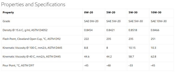

The more I read into the current Mobil 1 Triple Action formulation, the more I think they're using ANs, which is a good thing.  A XOM patent from 2018 suggests this as well.  If you look at the current version of Mobil 1, the additive levels are very very low.
ANs tank your pour point and Mobil 1 Triple Action 5w30 has a pour point of only -33C.  That's not that great and suggests to me they're using AN in a good amount, which also aligns with the patent.  Also consider that Mobil and King Industries are the only two companies in the US that make them.
This is the High Mileage Mobil 1 Triple, which has even a tad bit more of Ca and Mg but look how low it is.  I'm thinking the ANs are what keep the engine clean.
You sure about that? It couldn't carry the 5W* label.
SAE J300 Table

3 hours ago, VicFirth said:
I got if from here:
Yep I see that. Read: Engine Oil Pour Point and Its Significance: A Comprehensive Guide - TechieScience It will explain the ASTM D97 pour point test.
Then explain how a fluid that is solid at -33C can still pass the MRV at -35C😏
Are the facts different in English? No, AND they are cheaper in Chinese. FREE The most current J300 the SAE want's a hundred dollars for. Right :idiot:
Oh, and I will accept any reasonable explanation submitted with source.
Grumpy, addititives make electric motors rotate engines that have no business firing when the oil is gelatinous, not solid.  It's all about the chem structure of the liquid and its phase at a given temp. Including gelation that will cause aeration most severely if it does start.
Why do we have to keep going over this over and over.
Understood on the cost, its why we outsourced this country to China for 45 years.  Sources?  My brain.
Maybe because it doesn't make sense.....
It's pumpable at -35 but solid at -33.
If it won't pour, it won't pump.
:idiot:
HPL 5W30 Premium Plus. A good dose of AN's in this one.
HPL PP line is full of AN's
:idiot:
You were talking about CCS and MRV it can crank but it won't pump then we agree.  Why are you so confusing? On purpose?   Just because pour point is a higher temp doesn't mean it won't allow an engine to spin in it.  YOU are the one who stated -33 pour point is solid, not anyone else here.  Are you arguing with self?  A temp below pour point is NOT EQUAL to solid.
