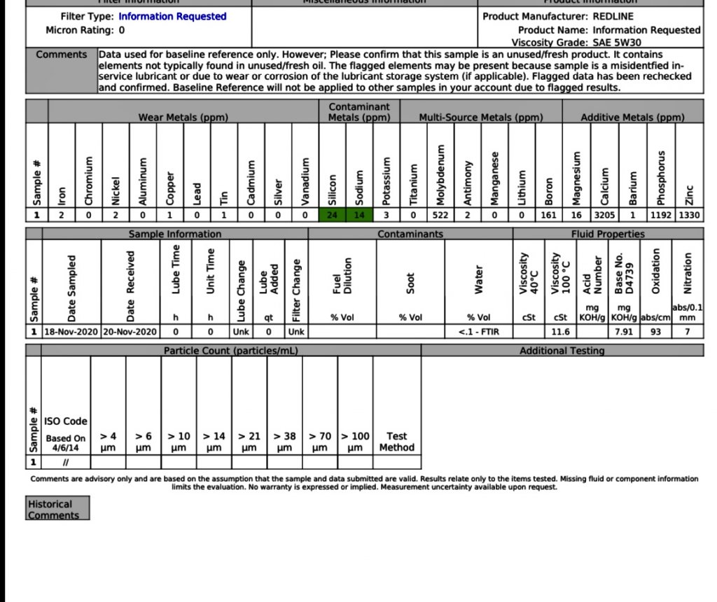

Practical Wisdom
The Maasai know more about Lions that anyone on earth, period. And still, they don't know it all. They work with scientist on the preservation of the species. These "Scientist" after failing to reach their goals thinking they knew it all, conceded that these people's knowledge and ways with the beast were invaluable and indispensable. Working together they have had great success. [source: Sir David Attenborough]
Science people try to convince me that only they know the truth about PCMO/HDMO, and my non-complacence will wreak havoc on my motor and anyone I guide.
Tell ya what I think. They DO KNOW the truth and yet they don't share it, not all of it. Just the parts that suit the agenda and that changes every few years. How sad is that? Rhetorical question.
True, Phosphorus compounds are cat killers. No two ways around it. The current limit is set at 800 ppm. "They IMPLY "Using an oil with more will damage the cats and O2". Is that true? Hum.... Did you get the whole story? Nope.
"They also imply that SAE SJ level of Zinc will corrode bearings.
The Government here in the USA forces the OEM to warranty the converter for 80,000 miles or 8 years.
Pepper has been on a diet of Red Line HP for the bulk of her life. Now 176K. Almost 1200 ppm Phosphorus and over 1300 ppm Zinc.  She uses a bit of oil these days. How are my cats and O2's? Stellar!
So, what were you not told? The amount of oil used during testing! It's a huge amount. An amount that would have you filling the crankcase several times in one OEM recommended 7500 cycle.
Practical wisdom says that taken on its face the tribologist, researchers, the government regulators and science types are lying. This is where they pick nits. They think a lie is something that is always told. They don't believe in lies of omission. I do.
My 70 years on this planet and the practical knowledge and wisdom that brings will not be dismissed by an agenda whose purpose is not aligned with my best interests. It is so sad that these two groups cannot work together but truth is some like to have all the marbles even if it means they have no one to play with.
I'm not the guy sorting through information to find what I LIKE. I'm the guy looking for what WORKS.

Huh?
I get that you like what works but things advance and I just showed you and the readers that new oil additiive formulations like Chevron ADF 600 can protect HD diesel AND CNG engines with much higher contact pressures and cylinder pressures than our GM spark engines WITH ALMOST 0 ZDDP.
I like Redline formulations too.  I could care less about brand.
You as usual are nonsensical answering a direct science based fact. You get your facts from the internet NOT current science based improvements.
Now you will reply with a post attacking the words I used but anyone reading this go look at that Chevron Chemistry and see that a load of ZDDP is not required for EP or  wear control anymore.
I like you Brother but you are mostly a handwaver.
