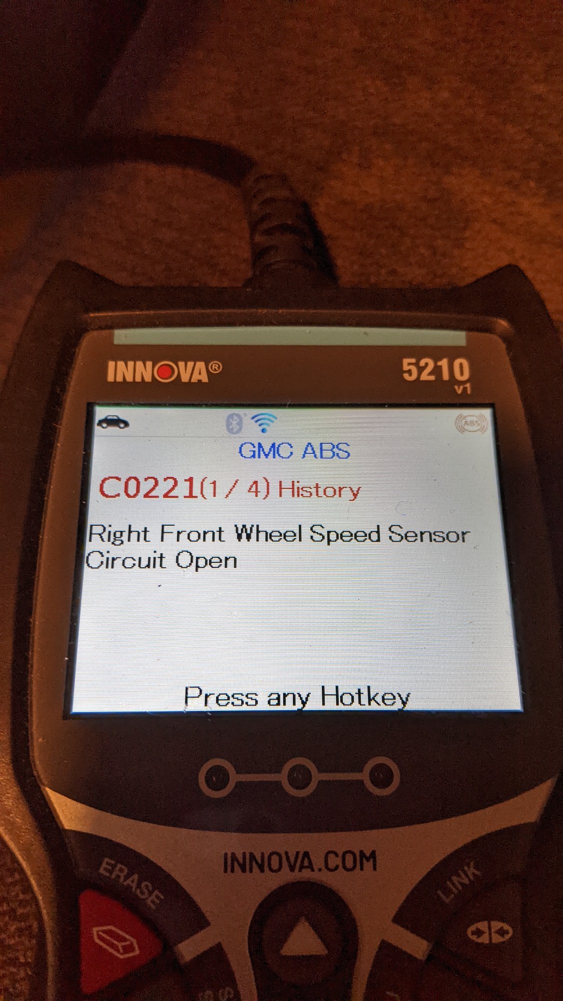

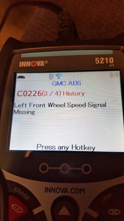

Just bought this truck and noticed at low speed ABS activates when I'm almost at a complete stop. Last stop I almost missed my garage and went through wall into my basement. Have 4 ABS codes to go with this feed. Listed in sequence as shown on scanner. C0221, C0222, C0226 and C0225. Wondering which would be highest priority.
Clear the codes and take it for a ride watching the speed of each wheel as you stop. The condition is called low speed drop out and is caused by usually 1  of the front abs sensors dropping the speed signal at low speed fooling the ABS computer to thinking a brake is locked up. Very common! The best fix is to replace the hub bearing assembly on the offending wheel(s) They come with new sensors installed for not much more $ than buying just the sensor. Until you can fix it pull the ABS fuse to disable the ABS system
