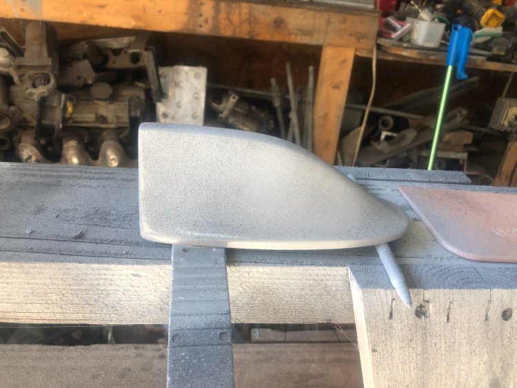

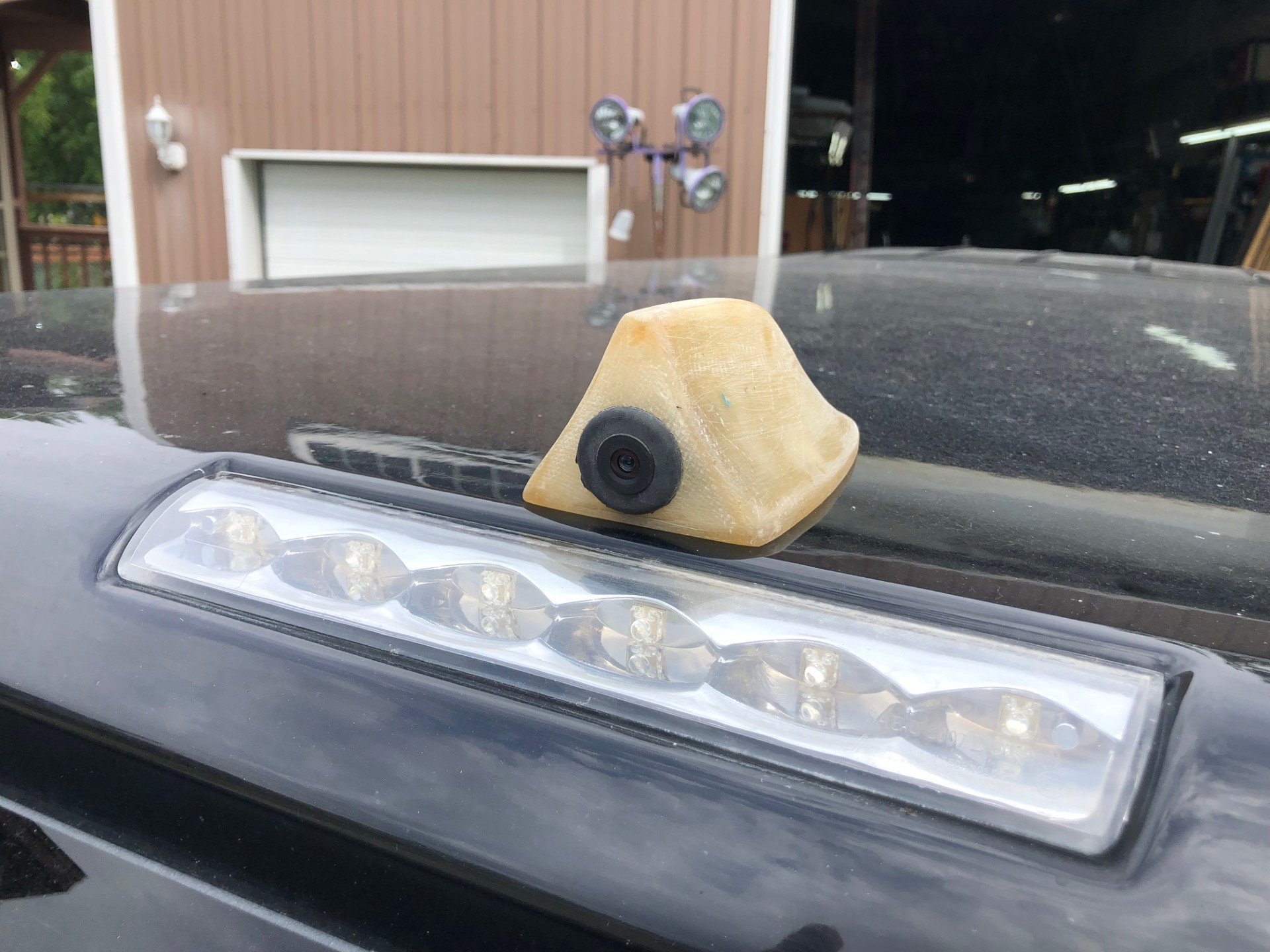

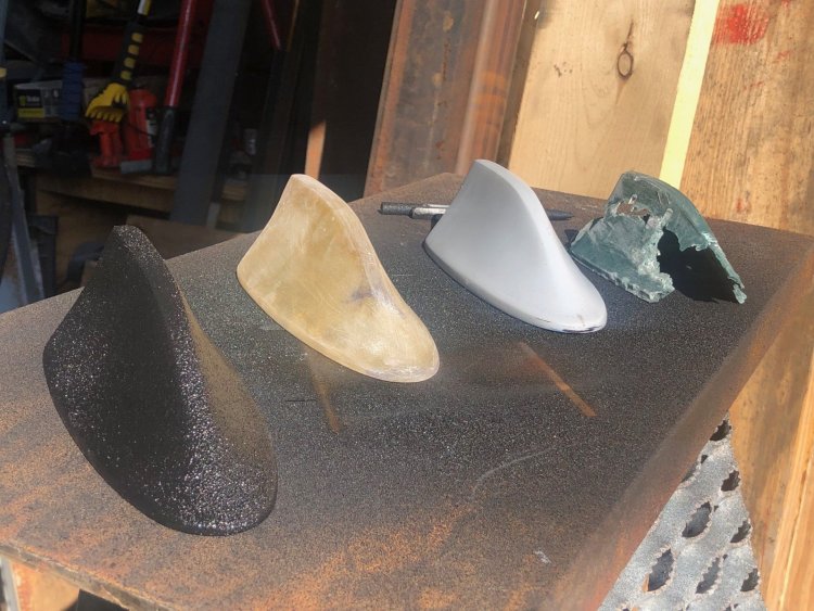

Thanks, I got a cheep ebay fin. remolded it to point down a little bit in the back. Did a cast then made a new one out of fiber glass.  took a few tries lol

How did you mount the camera in it?
It's a rubber grommet. fit the Lense tightly and fit into a 1" hole in the fin.  once i was happy with the camera alignment I epoxied the camera body to the fin inside.
