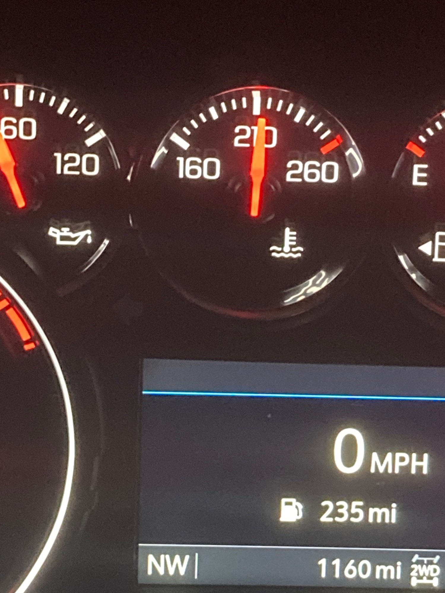

Temp gauge on cluster steady runs at 210 or slightly over with no load or trailer even in sub zero temps.  Just curious if this is what anyone else is seeing?  Had a bad cylinder head replaced with less than 100 miles so don’t kno if I’m over worrying everything now or if this is normal ….thanks 8C1C5795-5981-4BF1-85AF-45356D5D04BB.thumb.jpeg.7144293d45d1464e22a269a5d6d3ce3e.jpeg
That is typical. The same question was asked before and confirmed by several others that was typical, and my truck is the same.

if nothing is different on the 6.6 compared to the 5.3/6.2 the stock thermostats are 207F.
I run a scan gauge and the trucks gauge always sits at around 210 but the truck actually runs at 198-201 real temp. Sometimes if it’s super cold like below zero it will stay around 192 but if on the road long enough it will max out at that 198-201 range unloaded.
