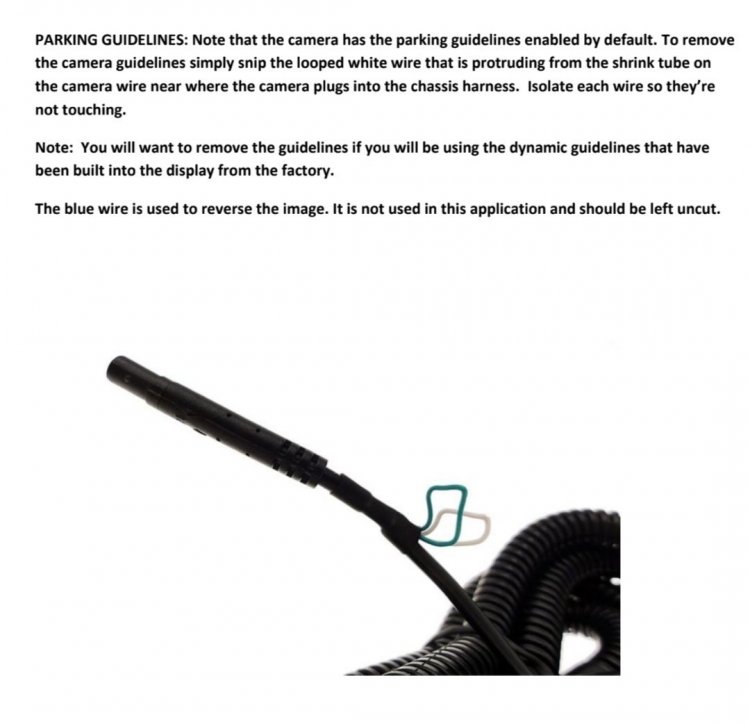

I replaced mine a few years ago with this one and it is GREAT.  Way better than the stock one.  I also left the small wire where I can reach it but didn't snip it so now I get the "factory" type yellow lines that turn when I move the wheel but also get stationary green-yellow-red lines in the display at the same time.

What wire was it, because i like it when the lines turn as i turn and I want to keep that

This may help. It's in the instructions.

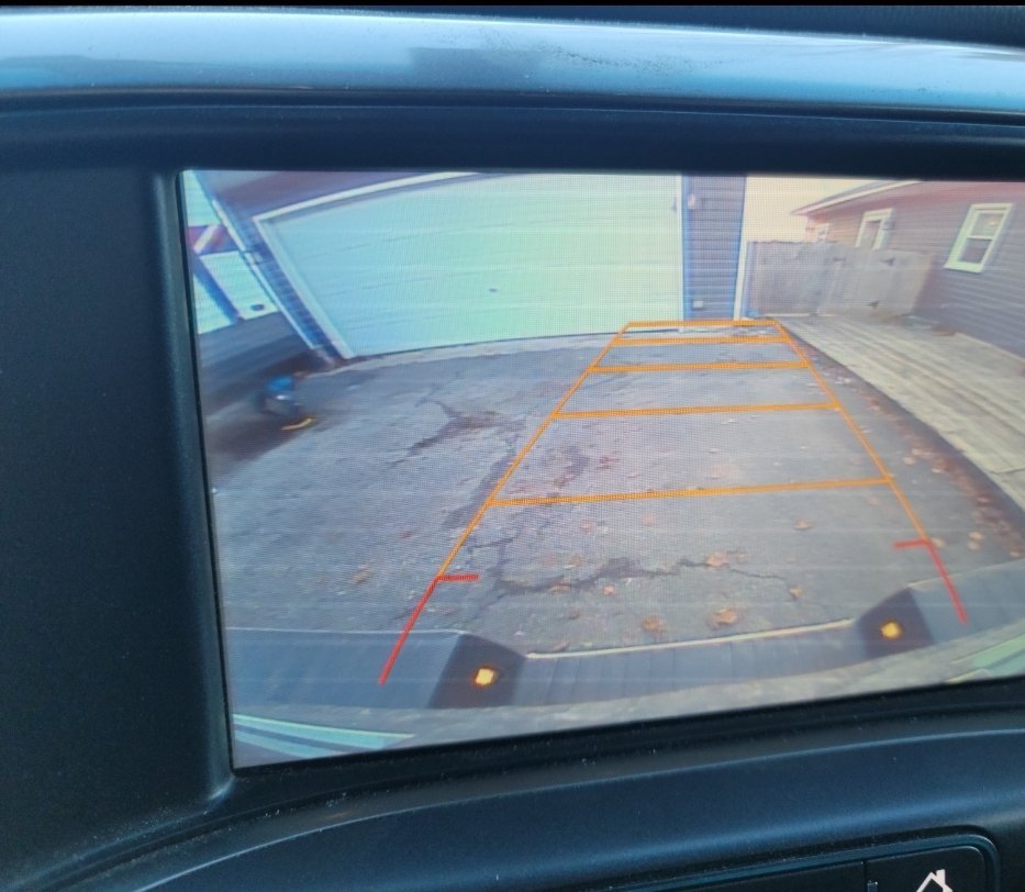

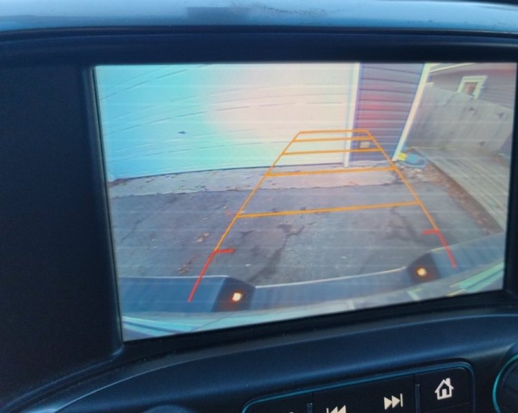

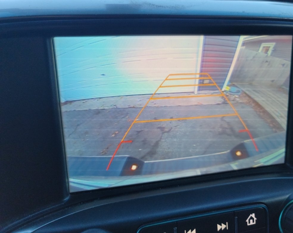

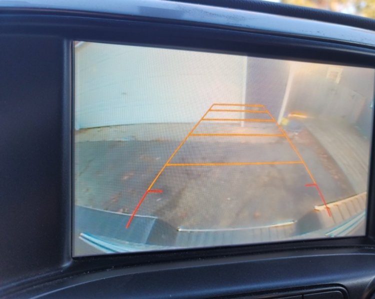

Camera got delivered earlier this afternoon but I had some errands to run and didn't get started til later. It's installed now and I have to say it's a big improvement. I will still have to see how it does at night, in the rain, and when sun is shining behind the truck. Here are some before and after photos. The phone camera doesn't completely show what I see on screen but I can say that the video seem much crisper.
Before
After
Some things I discovered while doing this. The camera wasn't too hard to get to. I removed the bed liner cover on tailgate and the metal cover over the latching mechanism to get to camera. The left torx camera screw was simple but getting the right one was a little more difficult because of limited space. I had a magnet that I used to grab it after it was loose. Camera just popped out after both screws removed.  A flashlight helps to locate those screws. There is a mounted clip for wiring for latch connector to hold that wiring in but I wasnt able to release it. I just removed the clip and then I used a ziptie around new harness into that hole and it should work just fine. As far as removing that 2 wired latch connector, there is a gray locking tab on top and it needs to slide out to release the connector
I didn't need to drop the spare to get to the connector under the bed. I had a head mounted flashlight that worked well to locate it. But removing the old camera connector sucked. There is one of those red locking tabs that needs to be pulled down. It didn't want to budge. I ended up using a pair of needle nosed pliers which broke it into pieces eventually. Luckily it doesn't matter because it is on the camera side of harness and won't get reused. It took a while but I was finally able to get the rest of that red tab to slide down enough to press on release and remove that connector. There are 2 wiring harness holders prior to wiring harness going into the tailgate and those both popped open pretty easily. Once the harness was loose under the bed, I tied on a long loose piece of wiring I had to the connector and then pulled old harness all the way through into tailgate by grabbing old camera. Once I got old camera and harness pulled through, I tied that loose wire onto connector of new harness and began pulling that into tailgate and back to under the bed. Then came installing the new camera. Again, not much room to work in there and my hands are a bit large. It took a bit of wrangling to get new camera in place and then I used a pair of heavy pliers resting on top of back of camera to hold it in place. The wiring to the camera wants to fight you and that didn't help. Once I finally got it in place and kind of held down, I made sure the locator pins were in proper place and then carefully installed the left torx screw and made sure not to drop it. The right screw was more difficult and I ended up dropping it into the tailgate! Luckily after searching for several minutes, I found it and was able to get it with my magnet. This time, I placed magnet close to the torx bit and then put the screw into the bit and it held. I slowly lowered it into place and was able to fully tighten it. I would highly suggest using a magnetic bit if you have one for this. Once camera was installed and latch wiring connector snapped into place, I began pulling on other end of that loose wire I was using to pull new harness through and out bottom of tailgate and under the bed. I pulled on it until I was able to get camera connector plugged in and then popped the hanging wiring back into this 2 holders. I closed the tailgate and tested camera and it worked. I also tested the lock button to make sure that the tailgate locked and unlocked. I was then able to reinstall the metal plate and bed liner tailgate cover.
So far I am impressed with the picture quality but need to see how it does in varying conditions.
