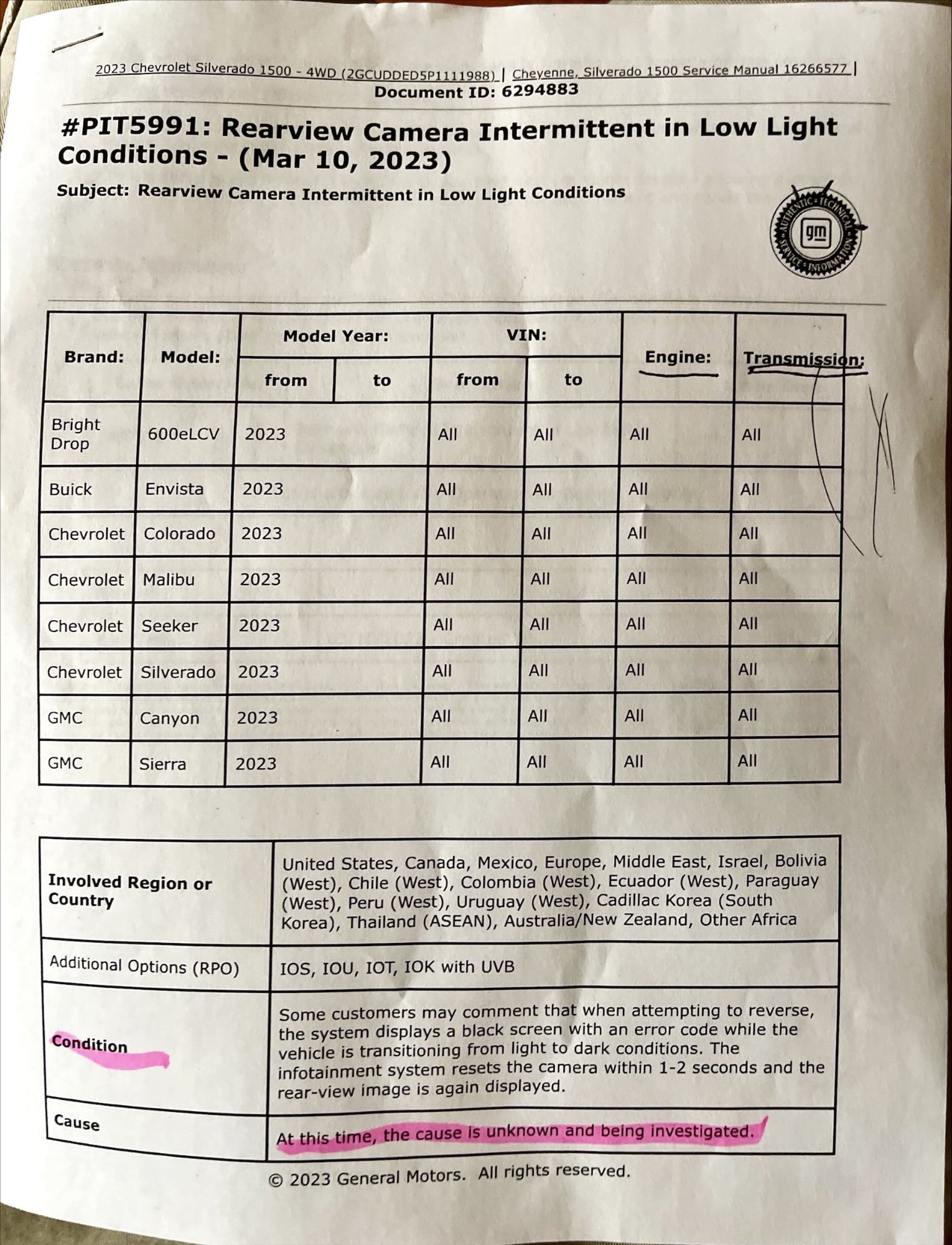

19 minutes ago, Gravel6621 said:
If anyone else is experiencing this issue at night, ask the dealership to lookup PIT5991.
Hi Gravel, is this a TSB that gm issued?
Yes, it's titled Rearview Camera Intermittent in Low Light Conditions.
However, when I spoke w/ Chevrolet customer service in an attempt to get some more information, they tried to convince me that the dealership made this and they had no way of locating it. I don't believe this to be true as multiple dealerships were able to look it up and confirm that it was generated by GM.
It's getting a bit annoying at this point as I do a lot of night driving and the camera is essentially ineffective.

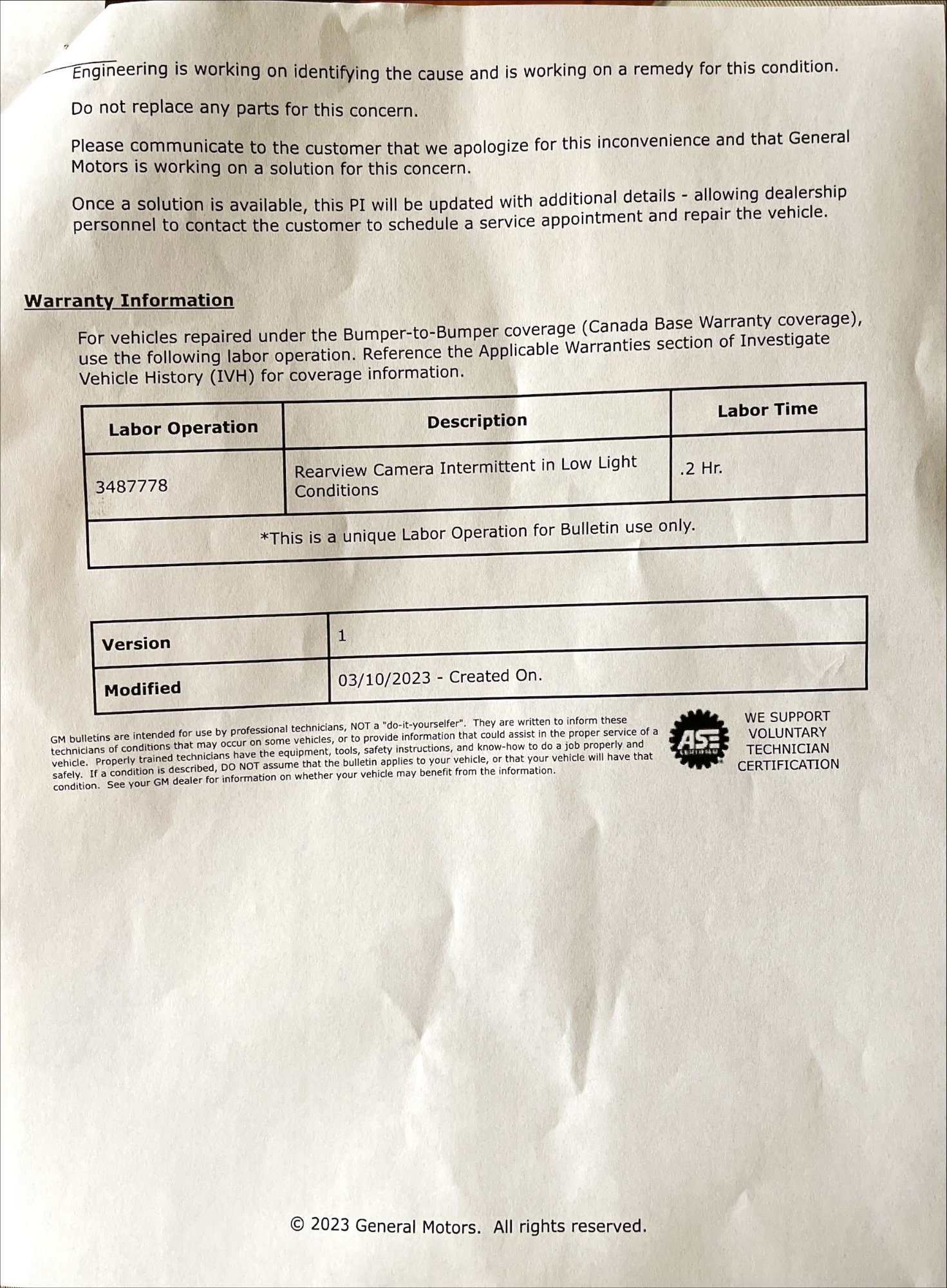

I forgot to mention, there is currently no fix. It just says that engineering is working on identifying the cause and to not replace any parts.
Gravel,
I sure do appreciate that update, thank you.

I followed up with your suggestion and attached the photograph of the error that happened the very same day we picked the vehicle up from the dealership that was supposed to address this problem.

My 22 has been doing this since the day I bought it. It's been to 3 different dealers and none have found anything wrong of course. No updates available according to all of them.
The manufacturer has no idea whatsoever on how to fix this problem, let alone what causes it. Nor are they willing to replace anything.
Probably would have been better off buying a ford.
5-4-23, 12:58 PM Microsoft Lens 2.jpeg
5-4-23, 12:58 PM Microsoft Lens(1) 1.jpeg
Have you heard anything new on this? Last I checked I was told there is still no fix.
No fix yet, they said to call the dealer every couple of weeks and touch base with them. Very frustrating and amazing that they can even find a work around for their own product. This has been happening for some time with several different models. So I wouldn’t hold my breath for a fix. No telling if engineers are even working on it.

Thanks for the information.  The backup camera on my 2022 Refresh 1500 LT is also drops out and then comes back on at night.
One question - Since the PITT5991 only specifies 2023 Silverados, does anyone know if this also applies to 2022 Refresh Silverados as well?
Thanks!
Thanks!
According to the bulletin, it does not. You can review the one files with NHTSA here.
