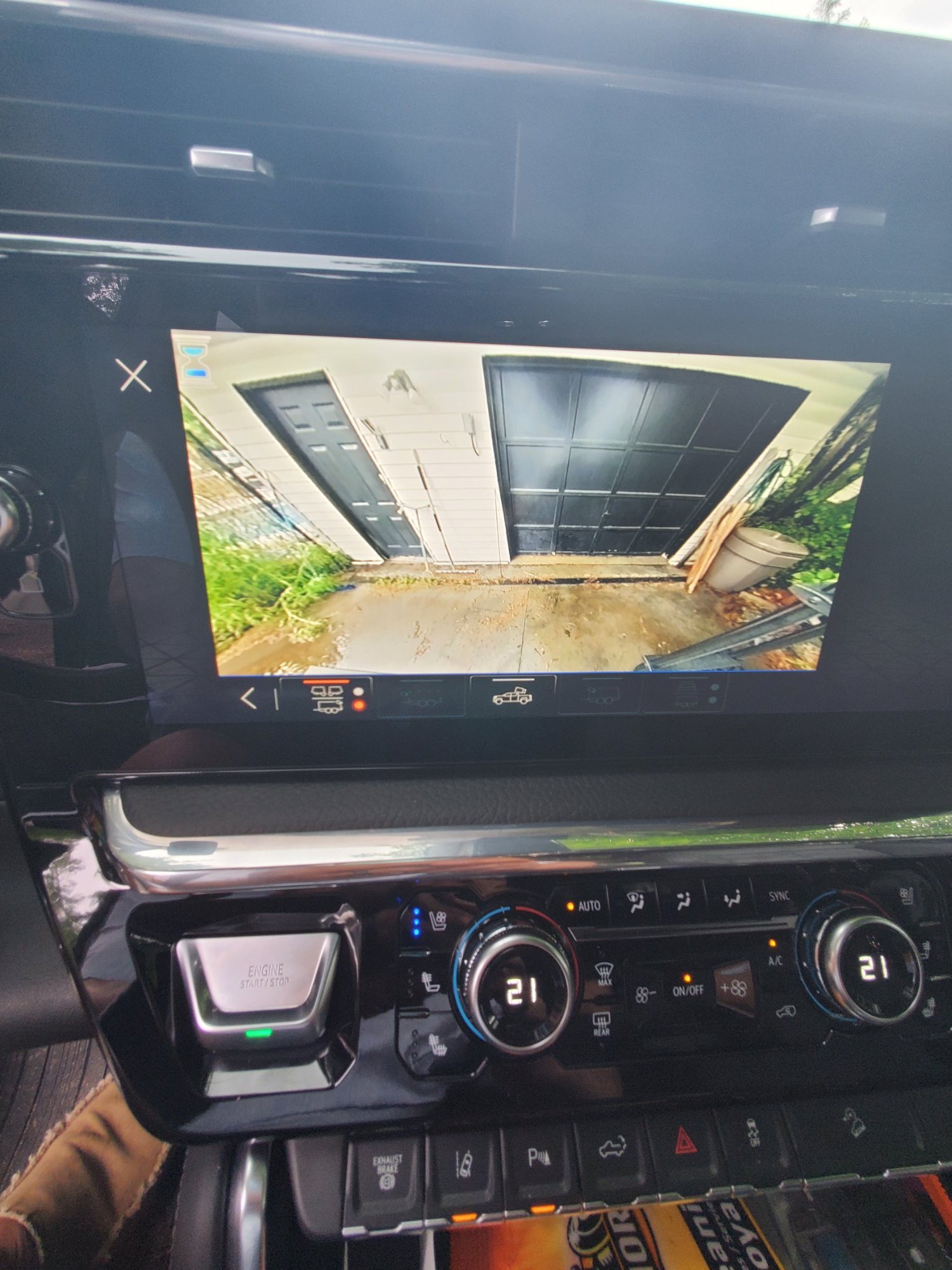

Thanks. The turn signal view works without the red carpet, it says drive to calibrate. None of the trailering featurs work. I have even deleted the trailer checked measurements and set up again. You tried to help me with the camera install in another post. Emailed GM and It is going into the dealer at end of the month. From other groups apparently the blue hourglass in top left in the below picture is a problem.20230626_144308.thumb.jpg.0f37cb904b1bd5c9978950930061b094.jpg
