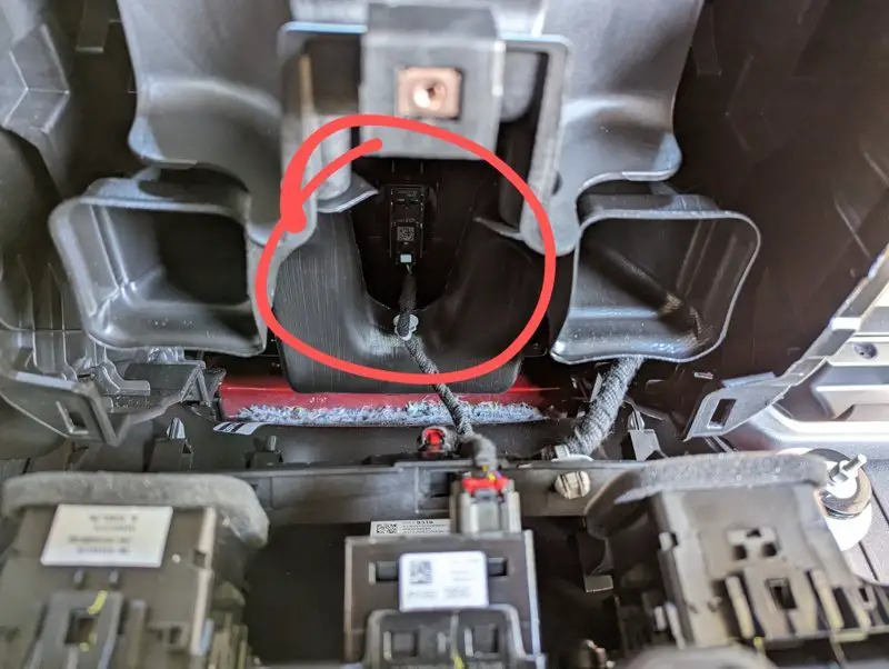

I took the back of my console apart to where I can see the entire lid hinge mechanism and wiring for the light, rear USB ports, etc. I don't see any kind of switch or place where the lid hinge mechanism would contact a switch, and no wiring except the terminations to the light, rear USB ports, and keyless entry antenna.
There is no wiring going into the console lid, either. If there's a switch, it would have to be at the front of the console where the lid latch is, and would have to be actuated by the latch points of the lid. I see no sign of anything in the holes in the console where the lid latches.

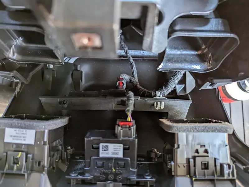

I attached two photos of the wiring on the inside of the console that I took when I had it apart over the weekend. One photo has the light circled in red. You may not be able to see clearly from the photos, but the wiring harness that comes back there terminates at only the locations that I mentioned in my previous post, then runs down to the floor / bottom of the console. There's no wiring that goes anywhere to the lid or hinges.

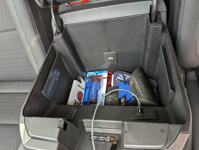

Here are photos of the console from the outside and with the lid open, showing where the light is.
As a followup, I stopped at the dealership this morning and asked the service advisor about this. He didn't know, but went to talk to one of the techs; he supposedly talked to one of the truck techs. The advisor told me that he started to ask the tech about it, and as soon as he mentioned the light in the storage compartment, the tech cut him off and completed his sentence, assuming that I was asking about the light staying on all the time. The tech claims that's the way they all are, and that the light just stays on all the time until the timeout after the truck is shut off.
Seems ridiculous that they would engineer the thing without a switch for the light, but that's the answer I got from the dealership, for what it's worth.
Sorry to say your console is slightly different than mine. I can see from your pic that you have no switch between the hinges on the armrest/cover where mine has a switch.  I agree that its ridiculous that thereis no switch to turn the light off. Apparently Chevrolet is using the Retained Accesory Power (RAP) circuit to time out the light so the light would stay on all the time that the ignition is on.
