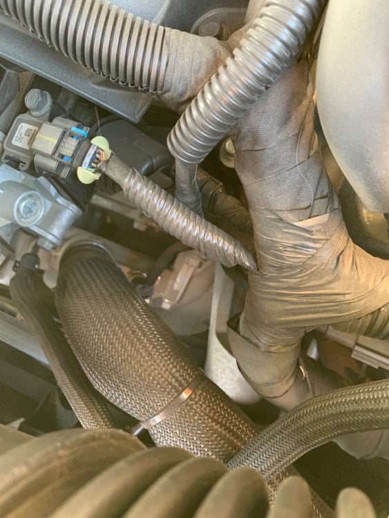

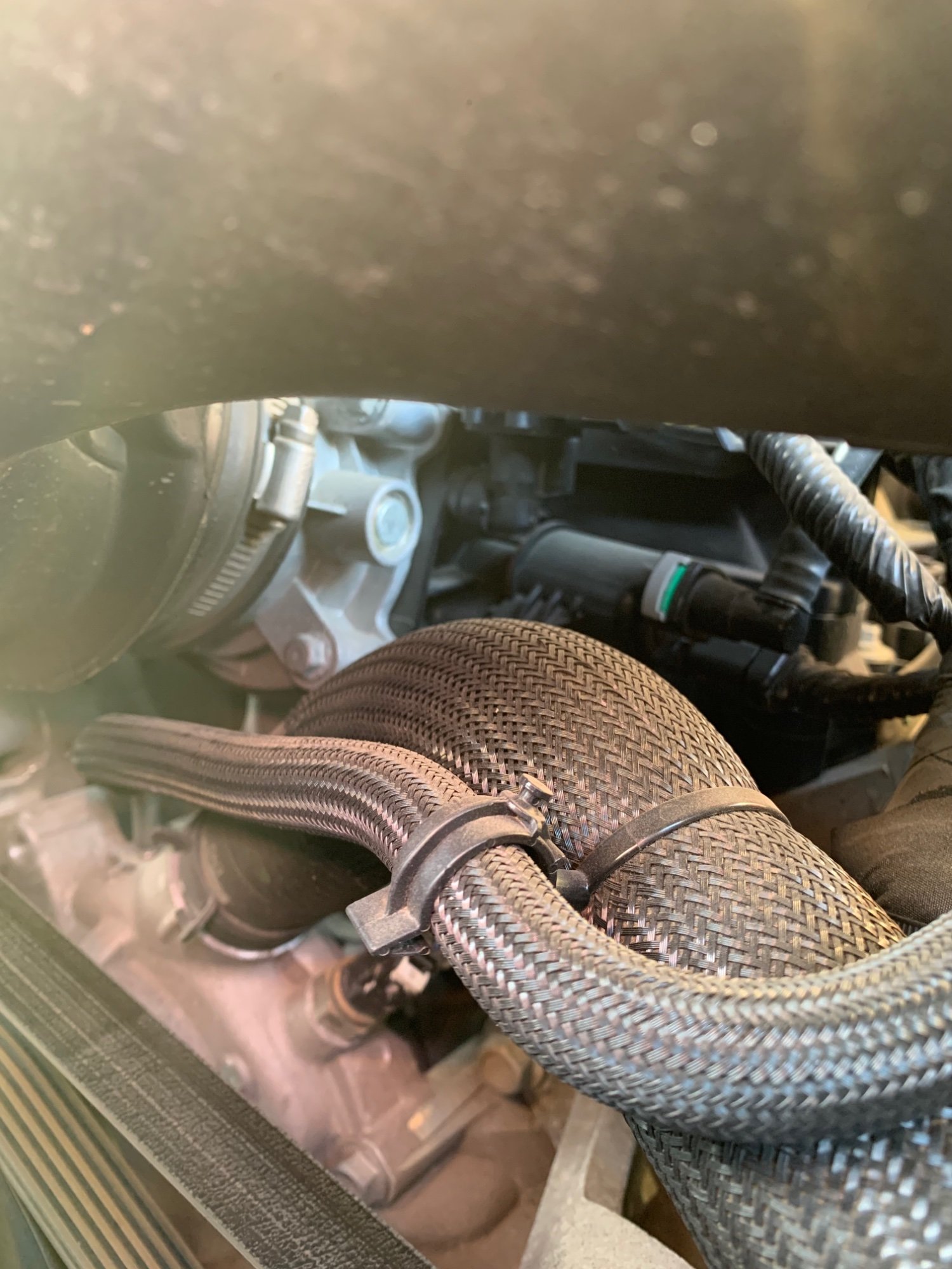

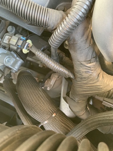

My 2019 LTZ 5.3 with 55k started running 215f. Maybe 212. Seems like over the last month the stat is holding closed about 5 degrees more. Not huge but noticed the fan which used never come on now does after a brief heat soak. Again not huge but figured I’d just replace the stat. This series is a WAY bigger pain than previous models. Looks like the stat is in the lower hose connection which is going to take twice the work.
Thoughts???

Nothing unusual going on here. A 'brief' hot soak drives heat into the water which must pass through the thermostat and past the sending unit. It spikes. Spikes high enough on a hot day and the fans turn on. Fans will also turn on when the AC is on under certain conditions. Will even stay on in stop and go with AC on. I actually use this to my advantage on such days. Did so today in an Interstate construction zone I got caught up in. With the AC off water might reach 220 F. With it on it never gets past 190 F.
Your thermostat on the 5.3 is in the same place it has been since these motors were introduced in 2014. Top hose, motor side of that hose.
Only unusualality is the change….
I need to look again but I saw no housing where the upper hose entered the intake. Thanks GB
Edited by DHBWA
 I must be missing something…Mine isn’t like that or I need to climb up and check better
Edited by DHBWA
Ah the water pump changed with the new body style.
The thermostat is on the lower left side then.
