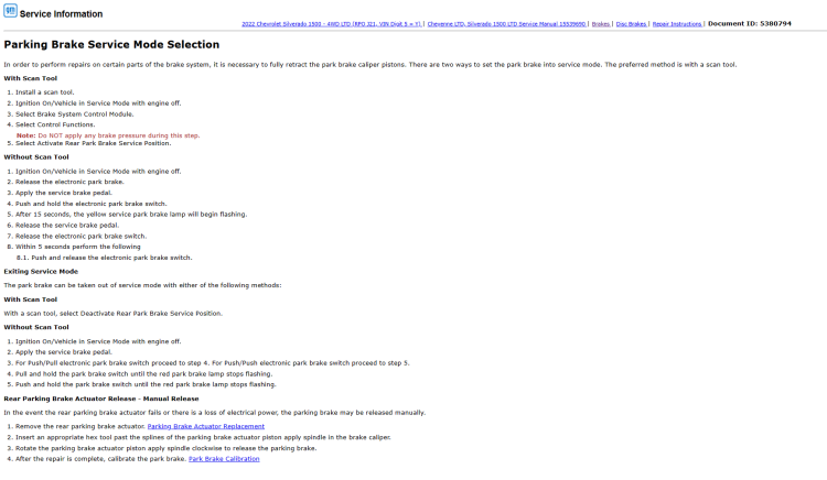

Our techs have tried this supposed "service mode".  Doesn't work.  Nowhere in GM Service Information does it list ANY alternate procedures other than the use of a scan tool to retract and extend the pistons.

Well it appears I've got some egg on my face as the w/o scan tool procedure was not in the manual.
It now is.
Not sure when they added this.  It was not there in the 2019-2021 trucks, under 2022 LTD I see it so I'd imagine they edited this for all the years 2019-2024.
