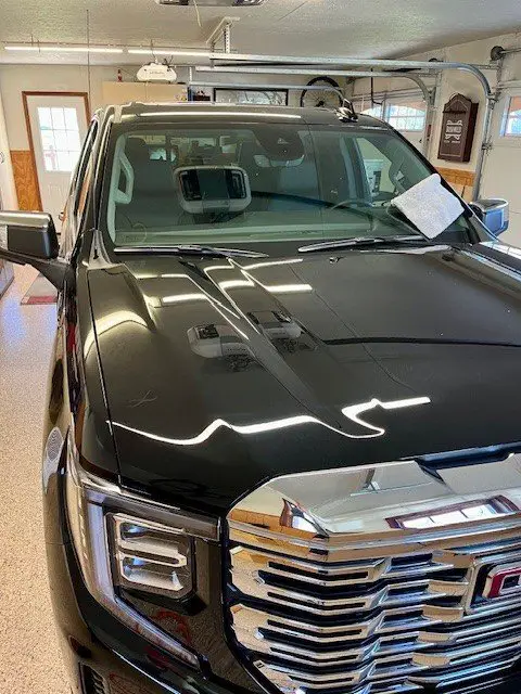

I debated whether or not a light polish was necessary.  The truck only has 2,500 miles on it.  Paint is in excellent condition as you can see.  I think I'm still going to hit it tonight.  I have a Porter Cable random orbital buffer I'll use with the Meguiars polish, has a very light polishing effect.  This is more to remove the existing coat of wax.  There are a few small light scratches I could see, walking around the truck with a work light.  This should knock those down, remove the existing wax and hopefully be ready to start the ceramic coating tomorrow.  polish.jpg.637316b674390cfe4e41a6bf063969ff.jpg

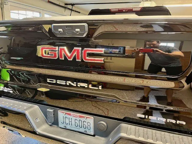

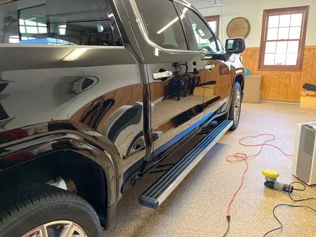

I picked up on this project again today.  Been sitting since Thurs night.  Got all my supplies from Adams.  Worked with the porter cable random orbital buffer and Meguiars polish which is very light for very light scuffs and overall cleaning, not any sort of real cut for deep scratches or swirls but truck is new so that's cool.  Spent about 3 hrs to get it right.  Ended up going over a few areas twice and spent longer than I should've making sure everything was buffed off after, kinda hard in the garage even with bright LED's and a couple work lights.  I wouldn't have spent as much time but knowing this job should last a few years, I was willing to spend the extra time.
Overall very happy.  Ready to hit it with the prep spray in the morning and lay down the Ceramic.  hoping that only takes about 1.5 more hours.   Tailgate shine is insane.

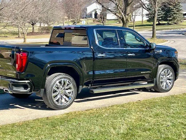

it's been 2 weeks now since I coated my truck.  Had a bunch of snow this weekend and lots of salt on the roads.  Took out my hose yesterday and just sprayed the truck down, no soap, no sponge, nothing.  looks freshly washed.
