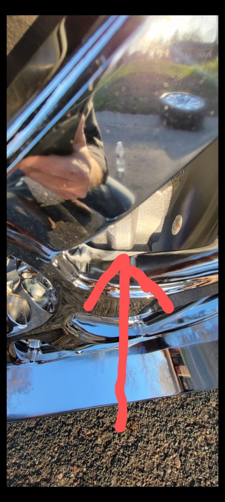

I recently got new wheels and tires and I don’t like how close my spokes are to the caliper. Custom offset recommends a 3/8 spacer. Will I have enough lug length left after that or should I order a 6mm spacer instead? I’m looking at Bora hub and wheel centric ones. Any insight would be appreciated thank you.

They’re not hitting but it’s like the smallest gap. Maybe 1-2mm at most. I’m just not comfortable with that. Thank you for the insight.

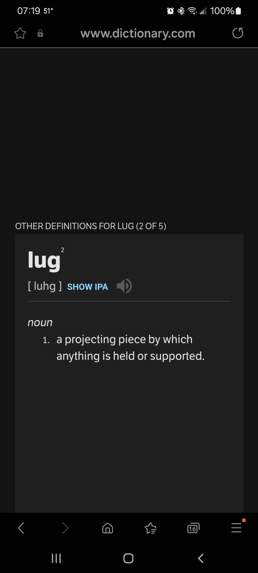

Oh, btw, if you go to Google and search "definition of lug" you will not notice anything for electrical terminals, but mostly for a behavior such as "lugging around."  I did manage to find this on Dictionary.com as the 2nd definition for "lug."  It sure sounds like a "wheel stud" to me.
