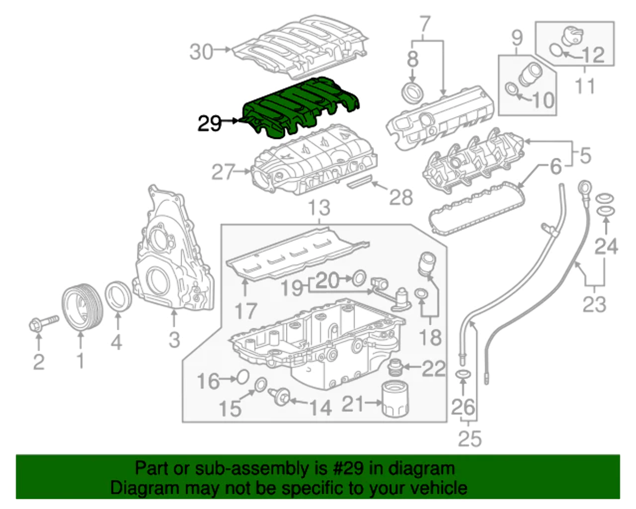

Does anyone have a part number for the insulator from a 6.2 L86 intake manifold.
The rubber insert to help reduce noise.
My new L86 manifold I ordered from rockauto didn't include this noise insulator. Do the L86 even have them?
My L83 manifold I replaced definitely had one.
(Picture for reference but not sure if it's an L86)

In my box of parts, I find no insulator. This is off a 2017 with 6.2L I bought new. I have the intake, cam,lifters and an aerodynamic shield from the bottom probably due to aftermarket cat back exhaust.
Thanks very much for confirming that.
It appears there is no equivalent part from the L83 manifold.
