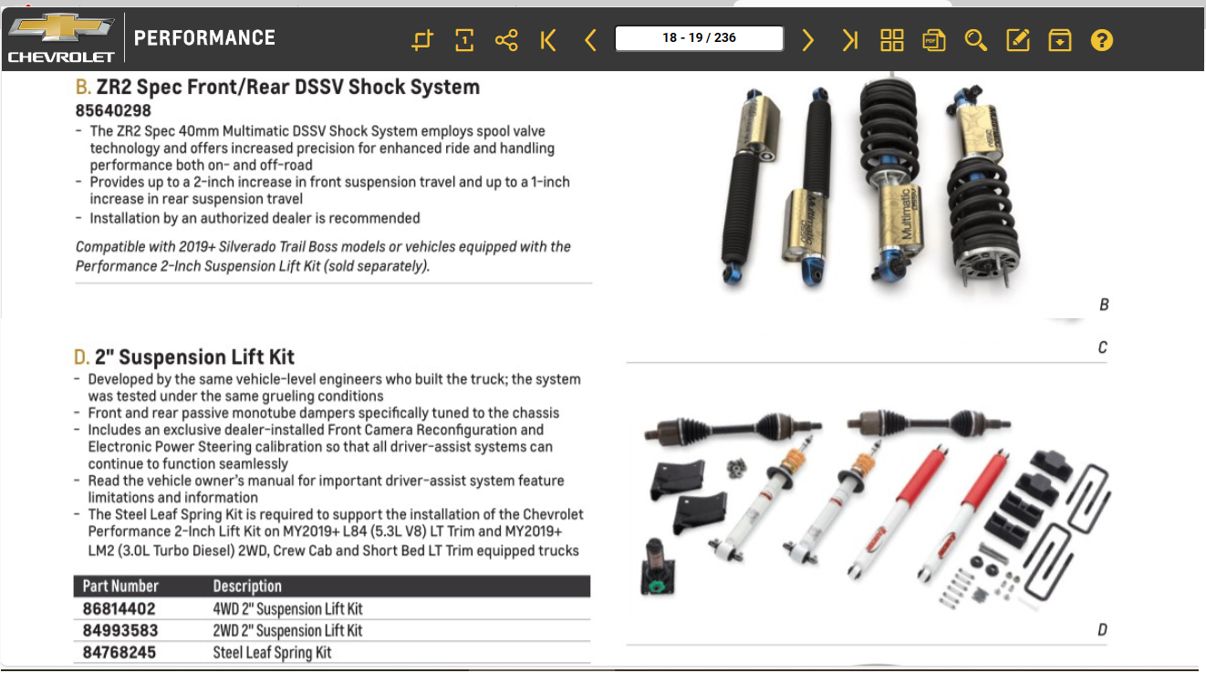

You need the 2 inch factory lift kit.  The DSSVs are required to have that installed before installing the DSSVs, so either the 2 inch kit has to be added or its got to be factory installed (Trail Boss, AT4).

The shocks and struts are 2” taller than stock. The struts make the front 2” taller by themselves.
You NEED nothing from the GM TB/AT4 kit. Just 2” taller rear blocks and u bolts.
Even the CV shafts are optional. Lots of us with 2” lifts are still on stock shafts without issue.

Just going off of what GM says.  Seen loads of popped out CVs and busted upper control arms from those who "shortcut" things on these T1 trucks.
40,000 miles on mine with TB height Bilsteins. No issues. Lots of folks on here doing it without issue. It’s the same ride height as a TB/AT4.
Going much past that requires control arms and CV shafts. GM’s just being cautious with the 2” TB lift.
GM says you have to have the TB kit to use with the DSSV shocks because they want you to buy it from them and pay to have it installed. Reality is there’s nothing that requires the GM components.
