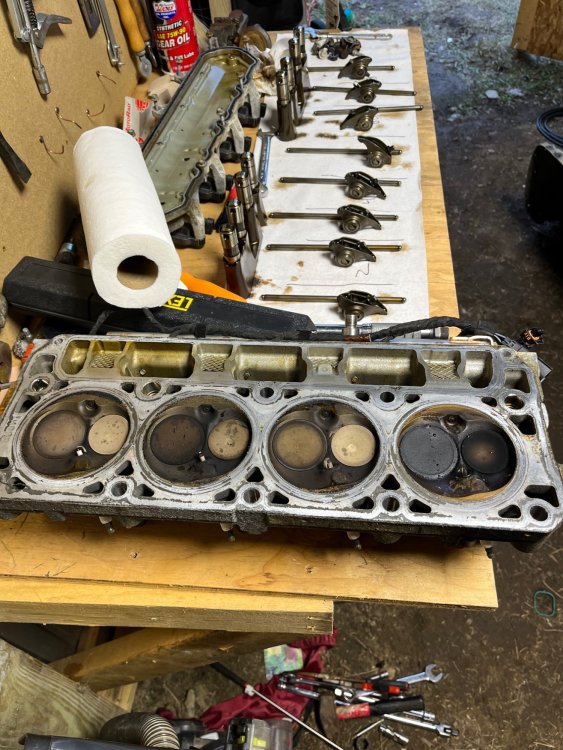

Ok so I decided to not buy another part until I actually found something damaged or wrong. Unfortunately that only left valves lifter and cams to check. So had a fun day today in the cold(northern Maine here) and here is what I found so far:
valve pic (cylinder 8 is the black valves)
