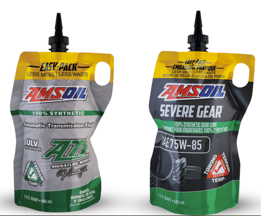

FWIW, AMSOIL will have a 75W-85 Gear Oil coming Nov 1.
Really...I'm actually surprised they didn't make that sooner given many light duty truck OEMs have been using it for some time now.

With the side plug fill on many new transmissions that squeeze bag will come in handy.
