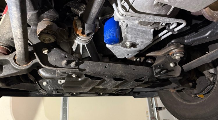

I have a 2025 Silverado 2500 4WD that I purchased near the end of December.  I got under the truck today and noted that the metal parts of the front axle are covered with surface rust.  Shouldn't those portions of the axle be powder coated or painted to protect the steel?  The truck had less than 20 miles on it when I bought it, and less than 2,000 miles now.  The truck was bought in Ft. Paine, AL and I live in Huntsville, AL, so no driving up north.
Does anyone else have this issue?
Pretty normal surface rust, those parts are not painted and mostly likely sit outside at the assembly plant waiting to be used on the line.. That's heavy gauge steel. The body will rust away long before those parts.

Unfortunately that is how GM leaves those parts, all unpainted and same here with my truck that came from the factory as a special order so not like it had sat around after the build or was being used as a demo vehicle on our salty winter roads. An interesting item this brings up though is that are all four of your upper/lower A arms painted, mine are but I noticed in the show room at the dealer that at least one side of the upper A arm of a HD trail boss was not painted and was all rusty just like your axle tube and that surprised me, somehow it must have gotten missed in the painting process unless there was another story to that particular truck.

Every truck does from GM and its normal.
Here's the PI from GM on underbody component corrosion and with pictures - PI0281I_en_US.xml
"Note: During transit between the plant and the dealer, some of the exhaust system components may corrode as a result of salt exposure. These exhaust parts are made of a bare mild-grade stainless steel that will oxidize, or appear rusty. Over time, these components will have a uniform rust-like discoloration, which should be considered a normal condition.
Recommendation
No repair or consideration should be given for this condition. Surface corrosion on unprotected components will vary with age and exposure. Corrosion on these components has no detrimental impacts, either in short or long term durability."

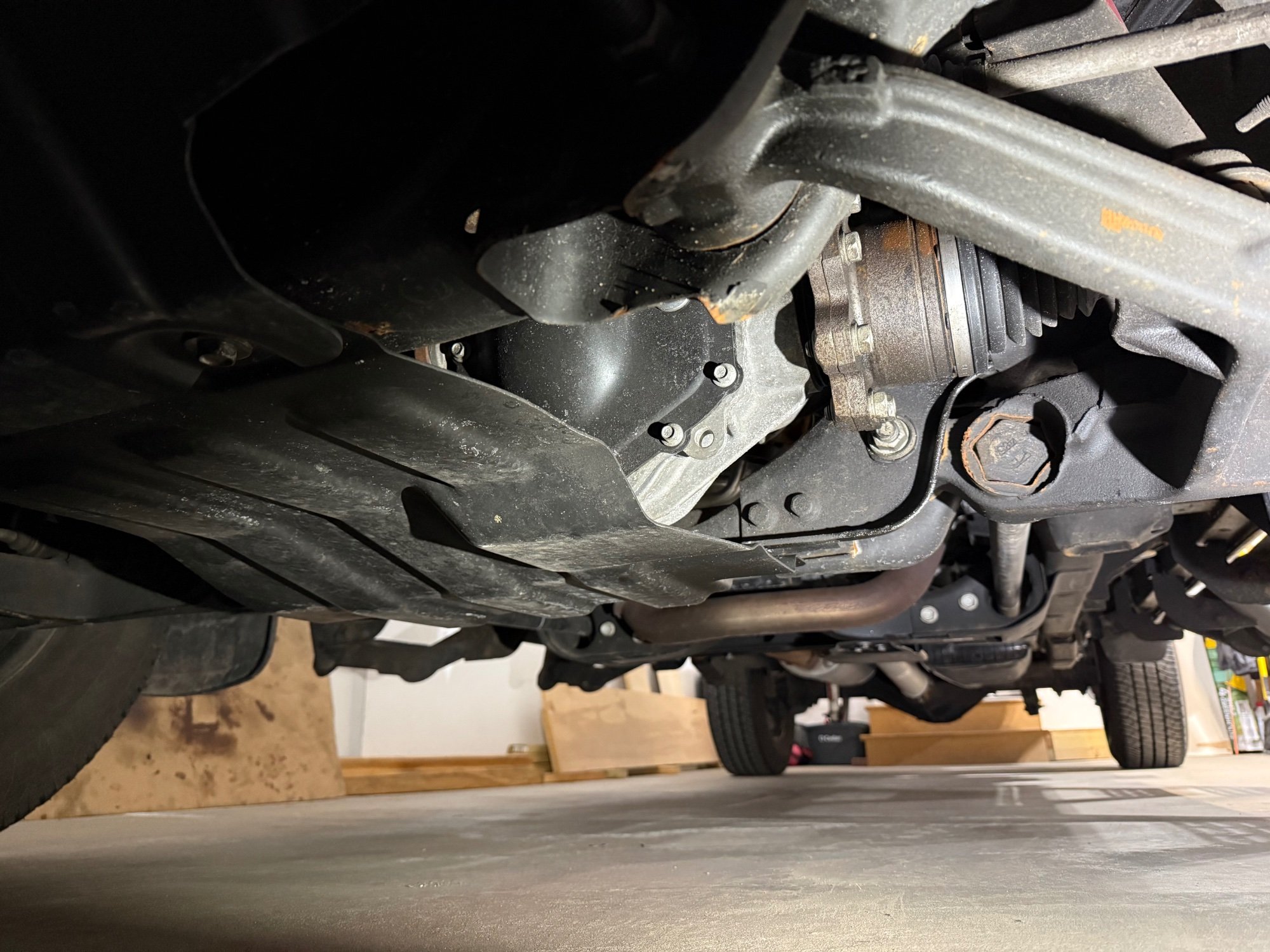

I bought my truck in Aug of 22 so it’s already been in a few winters and here is mine right now underneath. I have been using fluid film though.

I can tell you that where I live your frame would not look like it does if your truck was pounding up and down our winter roads, not only the salt and sand but they mix calcium chloride into some of their secret blends. A GM truck just a few years old will have no black frame at all but deep rust setting in by that point and a Ford is looking quite rough as well but better due to its painted frame but give them both a few more years and they are a sight to be seen under them, as well as any of the steel boded trucks. A friend that has a 2015 HD, in about 9 years time the rust popped through above the rear fenders and he talked to a body shop and they said there really isn't any proper fix, once that happens it just comes through a typical body repair fix ... so he threw on those wide flairs that cover the area to hide the mess as the truck has lots of mechanical life left as I think he had 80000 miles on it. So that is what I get to face unless I can protect it and prolong the ticking clock.
