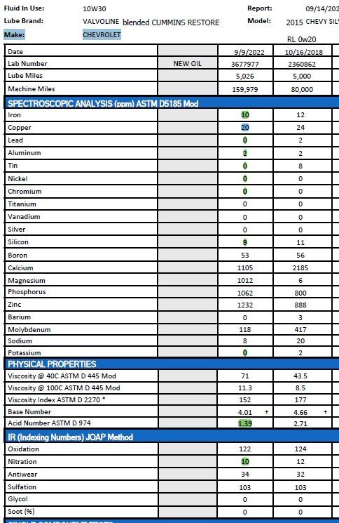

I ran a year (2019) with 0W20, kept records and ran a UOA. Then switched back to *W30 and ran another. See the Lead and Tin in the 0W20? Bearing materials. See it disappear with the 10W30? Otherwise very similar add packages. Did I get a bump in MPG. Best year ever, but not worth killing Pepper for it. I keep receipts. I document and I share. But if it takes a video and a GM major SNAFU and NTSB TSB to get your attention fine.... :rolleyes:

Two columns have other elements showing up in considerably different quantities, what are those?
Way more magnesium, zinc, phosphorus, etc.

Magnesium is an LSPI friendly substitute for Calcium. TBN's are very comparable. Add the Mg and Ca and you will see that it is nearly the same concentration as the Red Line HP calcium.
Yes, the ZDDP package is a bit more robust. The CUMMINS Valvoline Restore 10W30 is a diesel oil developed for freeing stuck rings in the CUMMINS ISx15. Mg is a more efficient dispersant but about the same as a neutralizer. This value has zero impact on bearing wear. That region is hydrodynamic lubrication. It had nearly no impact on ring/liner wear either. Remember that ZDDP and ZDTP are also antioxidants.
Lead and tin I discussed in the first post. Reduction in wear metals is viscosity generated. The silicon is an antifoam agent. Just a blenders choice on amount based on base oil foaming tendencies. Aluminum is mostly piston wear and identical. Copper is, in this case, oil cooler leaching. Slightly different reactivities. Neither seems to have much copper passivator.
Those things not 'wear metals' are just variations in chosen chemistries, like Moly content. Did I cover it all?
