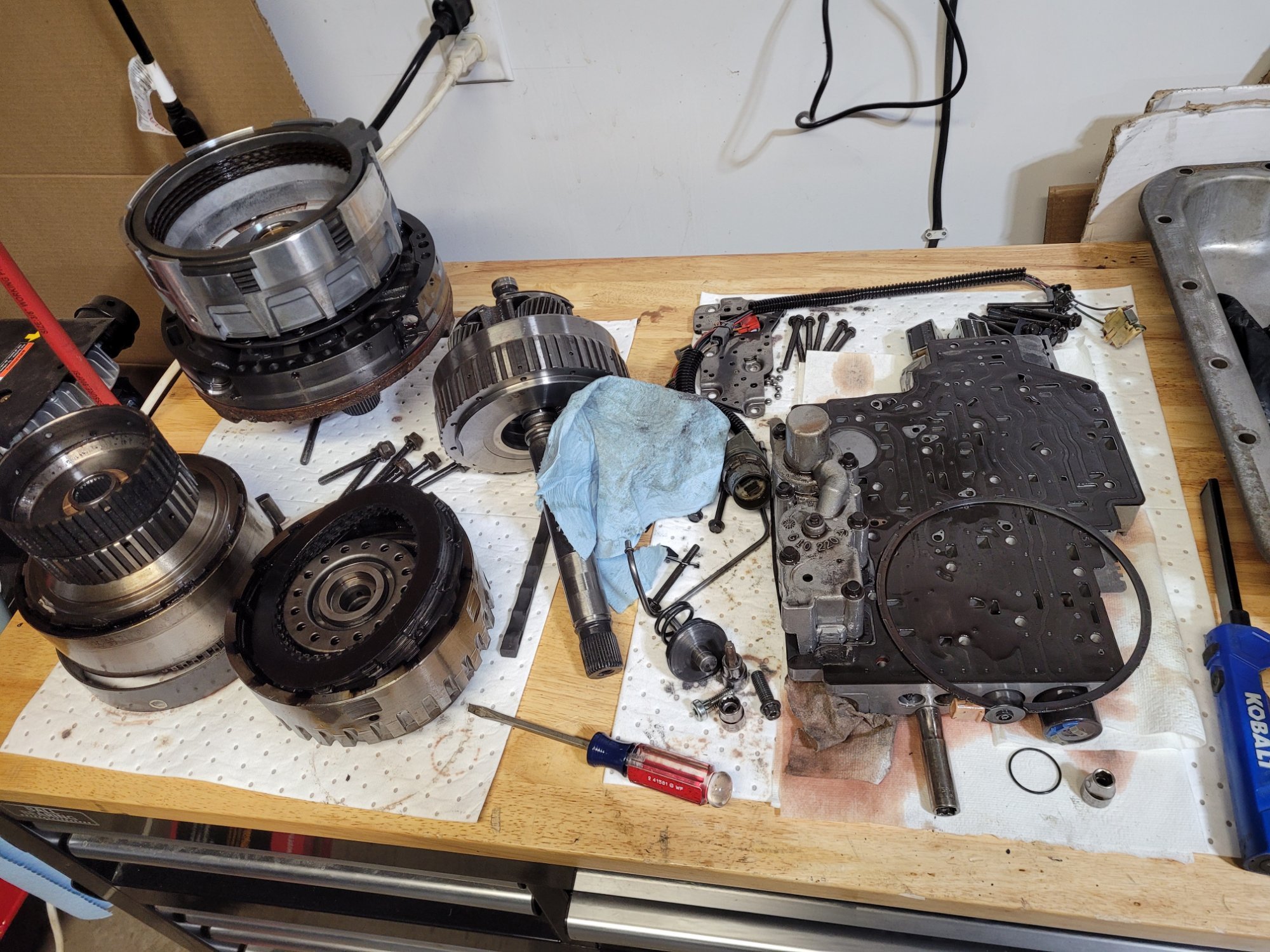

He yanked it out of a 2000 Chevy Express 2500 for me and snagged it for $60 plus the core cost and tax, a whopping $100 total. I was finding questionable transmissions on marketplace for 4x or even 6x that cost and who knows what was wrong with them.
After a ton of cleaning of the case I tore into it and found out why it was at the junkyard lol, has smoked forward clutches. So bad that they are fused together and couldn't pry them apart with a screw driver. The rest of the transmission is honestly in good shape, all the bushings and bearings look great still, minimal wear on parts.
Already ordered a rebuild kit and bought a new torque converter off Summit Racing.
