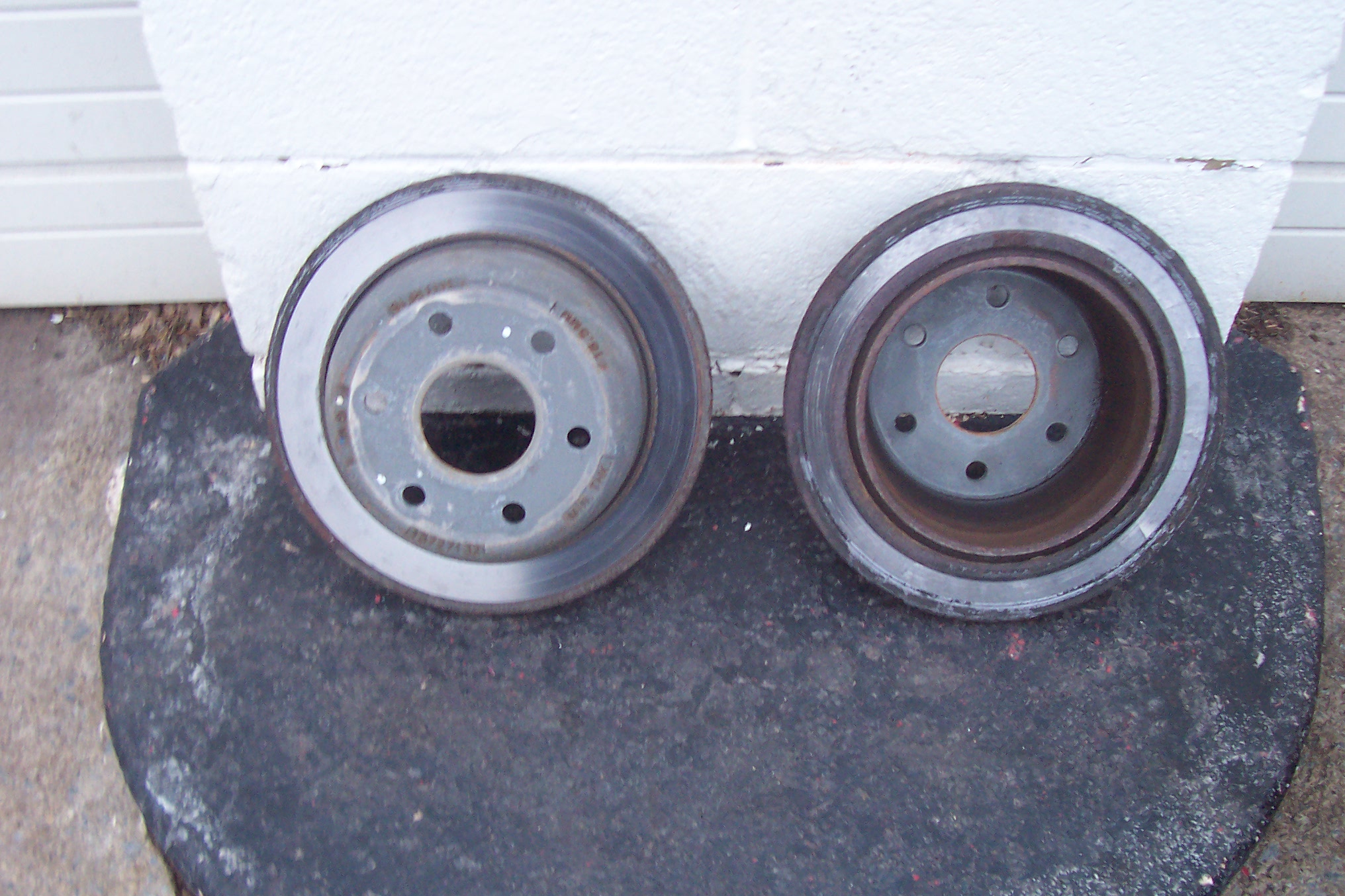

Had my truck inspected yesterday, and after 5 years it finally cost more than the stickers for inspection, and emissions.
The rear rotors with the integral emergency/parking brake housing were shot, and had to be replaced. The rotor part was bad. The E-brake section looked brand new.
Luckily I have those original stonecrusher brakepads, and the mechanic was able to dress them up, and I still have better than 50% left.

That would of been a big tip. Look a little closer at the rotor on the right, notice the cracks?
I've been accused of running 'em into the ground, :uhoh: ... :jester: but even I won't take that chance.
It's easy to go, but you better make sure you can stop!... :mad:

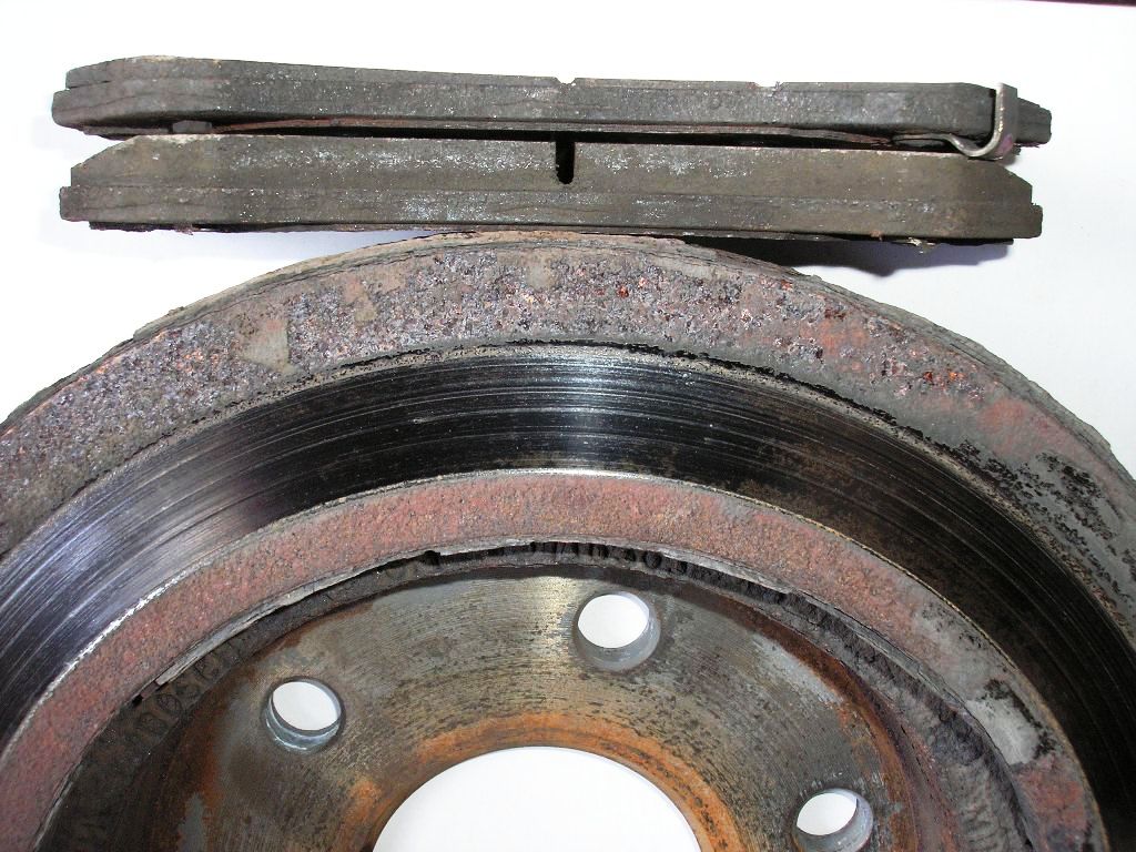

As much as it rains here in the Pacific Northwest, we typically don't see a lot of rus on brake rotors or suspension components t. Even in areas where it snows a lot, there is not much rust on bare metal components like rotors. Probably due to the use of calcium chloride for ice remobal instead of salt.
The pads on my 99 Silverado are at 50% after 74K and the rotors are still smooth with noting more than just some surface rust.

I actually had holes on the inboard side of my factory rear rotors in the swept area at 3 yrs and 55k miles. The Brembo OE replacement rotors are holding up much better. The factory rotors on a German car I own looked perfect aside from the lip from wear after 5 years. Since they both see the same conditions, I think there is a difference in the rotor quality.
