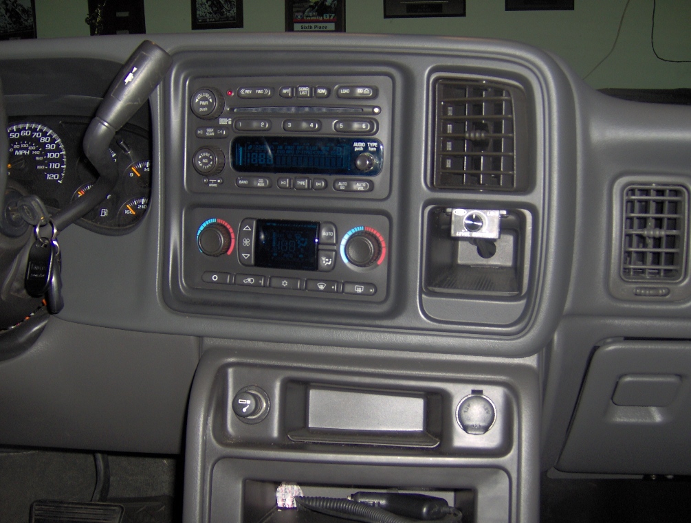

Replacing the head unit isn't bad. You just need the adapter harness. Here is basically how it works. The adapter harness plugs into the stock harness and then the other side of the adapter harness plugs into the head unit. And that's pretty much it, you get to keep your OnStar, chimes, etc with a new head unit to boot. There's no weird connections to make, no weird splices to make, just plug and play.

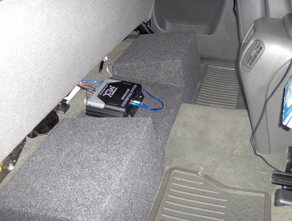

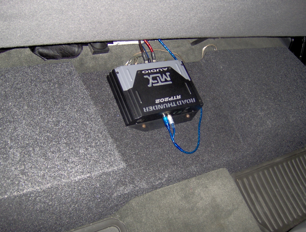

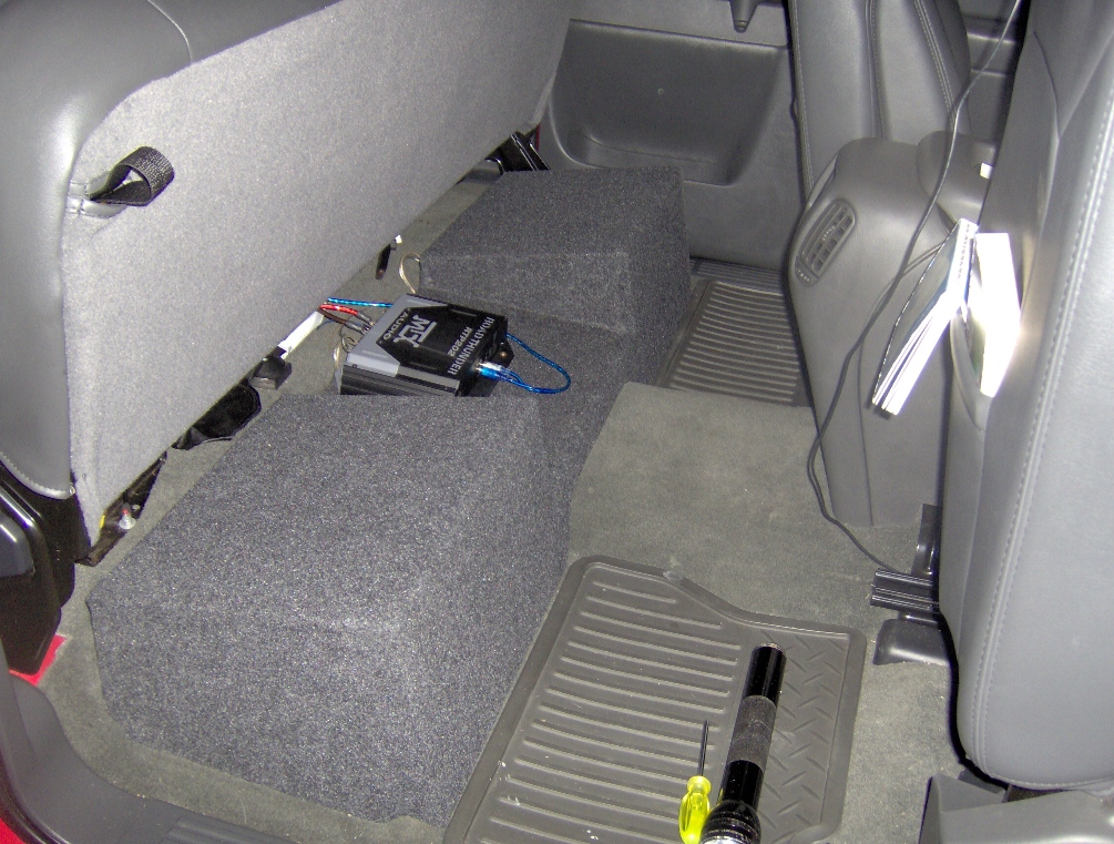

Mount the subs under the rear seat in a sub box made for that area. It's plug and play that way.

If it were me, this is what I would do. I would go with two 10" subs in a SubThump under the rear seat. It'll give you great bass and you'll be able to bump it up when you want to. Though you'll need to get new subs. I don't really see a good solution with the sub you have as it's just too deep.

I just got my system all set up; I kept my OEM HU & amp & sub in the center console. I just had to buy the adapters to do this. I wanted to have a separate bass volume so I also purchased the LC-1. Both the adapter and LC-1 are found out: http://pac-audio.com and I bought them on Amazon. I don't want to give exact links as your truck may be different because my truck is an 05' Silverado.
I went with a box that holds two 10" subs from subthump and I must say I do like it! The box is very high quality and I there is a place in between them to mount the amp. I went with a pair of Rockford Fosgate 10" subs (P1s810) I bought the 8 Ohm and then wired them in paralell so the amp sees a 4 Ohm load when I bridge it. I have a pair of 12" Rockford's in my GMC and they are still in great shape, just older (7-8 years) so I knew the quality. Plus, they don't require as much air space as the Kicker's I was looking at. I'm very happy with them, nice sound for both rock & club music. When I was looking I found a pair of 4 Ohm Rockford's on Crutchfield's site for $99. If you have am amp that is stable down to two Ohm, that would be a great deal.
BTW, stadt11 thanks for the tips and here are some pics of everything installed:
