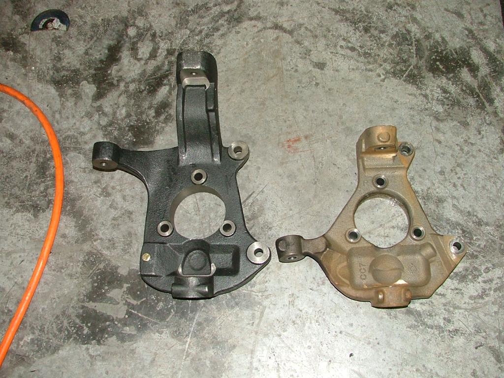

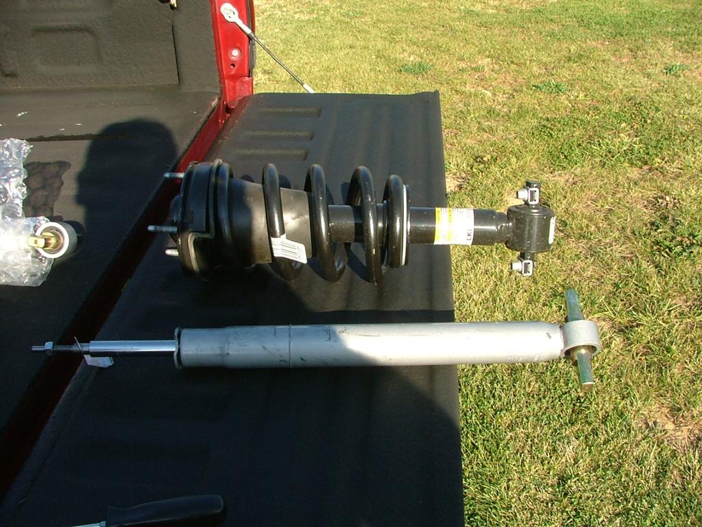

I'd take a look at the Superlift kit as well. With it you can use the stock wheels like I did on my truck. It's a great kit, right up there with the best. I got over 7" in the front when I installed mine.
alright i'll check that out. hows ur truck run with it?
I absolutely love it! he Denali comes with a suspension a little softer than a Silvy or Sierra. The Superlift I got was with the longer front superlift strut and rear bilstien shocks. It now has more of BMW 7-series feel. Very stable and comfortable. No rolling in the corners and you feel very little of the road unless it's rough.
The other guys are steering you in the right direction also. Fabtech and BDS are both super well built kits. In the end it's about choice.
I went with SuperLift because:
1. you can use the stock wheel (as in spare) so you don't have to buy 5 wheels if you decide to change
2. It keeps everything inside the factory wheel wells
3. They supply a stronger, longer front strut
4. they reposition the front diff the correct distance downward
5. and just the total quality of the kit. It fits like a gig-saw puzzel!
