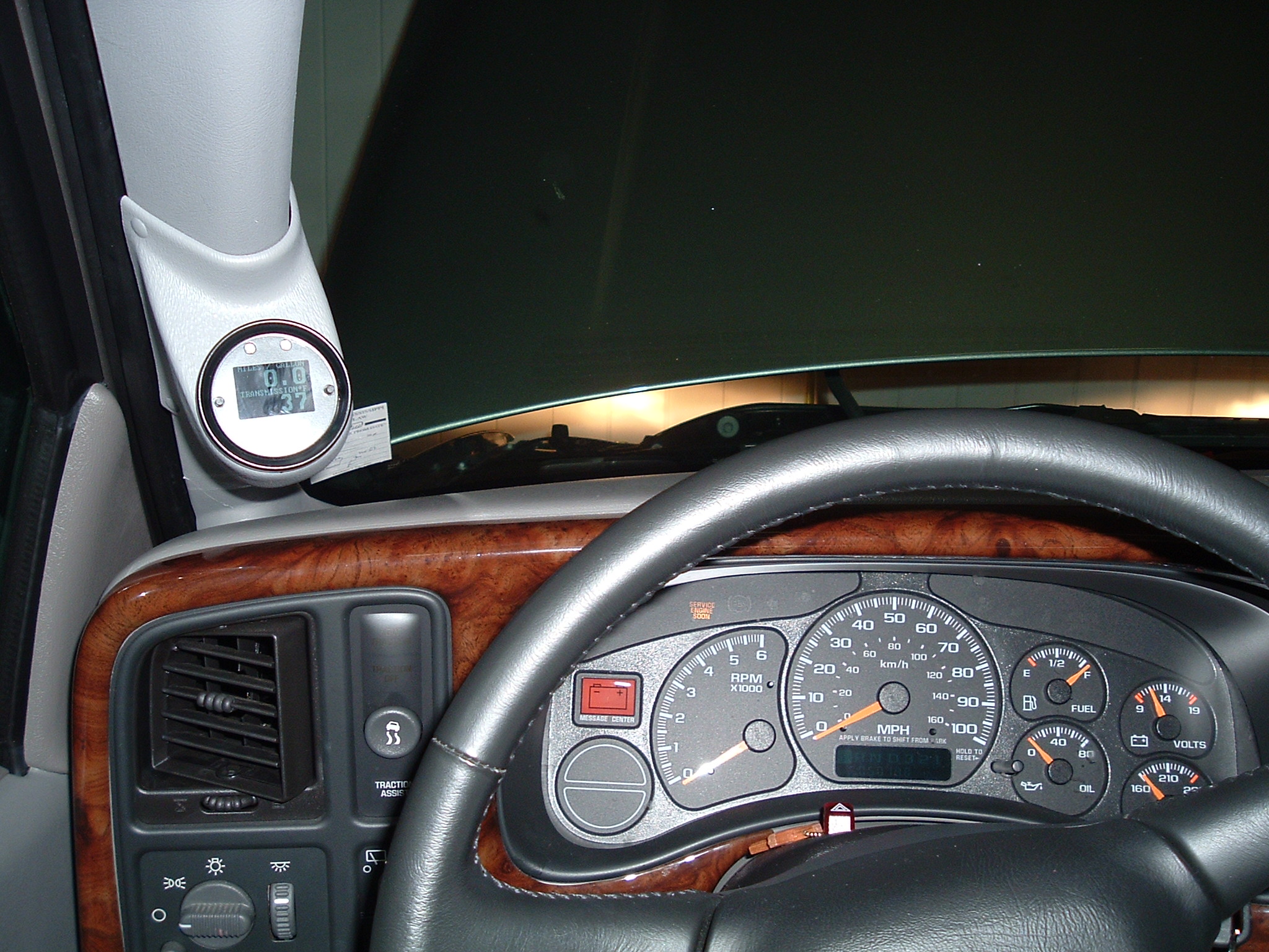

I considered this as well and after much research, I took the route of the Interceptor Scan Gauge by Aeroforce. I mounted mine in a gauge pod on my A pillar and it simply plugs into your OBD port under your dash. It will read appros 28 functions from your PCM.
See Their website
Also, here is a pic of mine installed.
