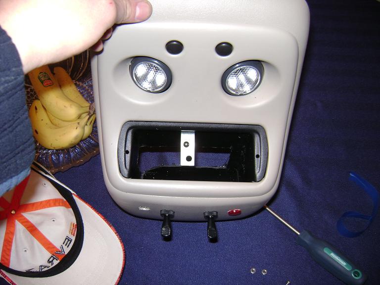

Hey all really hoping you can help me out with this one. I have started hacking apart my overhead console to accommodate my front driving lights, reverse driving lights and my scan gauge. I have everything fabbed up and just waiting for the face plate paint to dry so I ran the wires and scan gauge cable. problem is that my scan gauge cable is 1 to 2 inches short. I was looking at the OBDII port and it is held on by one bolt. question is if I am able to move that and mount it an inch higher to give me the play or if there is some sort of extension I can buy. thanks for the help, here are a few pics of the process and I will put up finished pics{hopefully today, that all depends on your guys advice).

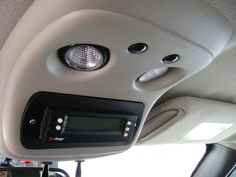

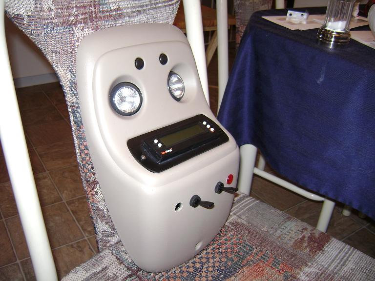

paint dried so I wanted to show you some pics.I made the cover out of and old drain pan i had kicking around. I still am not sure about the cable though

Looks good. I was thinking of getting one to keep an eye on things. Now I know where to put it. I'll have to add this to the list of mods to do.
Thanks but finally got it with a whole lot of reafing. I really like how it turned out the only thing I should have done was tilted towards the driver so I had a better view of it but I thought that might make it look out of place. I have no prob seeing it just have to turn my head more than I thought.
:withstupid: Great location and install.
