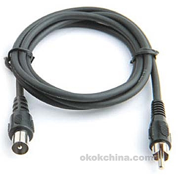

..soo if...we have one of these laying around at home,...is this what u mean?
....never mind,...answered my own question....the 2nd axis wouldnt be shielded....so no ring terminal.

...so I couldnt find this RG-58 cable,...soooo,..I did what any impaitent person would do and use RG-6 coax cable for audio/video, and put a ring terminal on each end of a 10" or so pc, and double heat shrunk each end.
