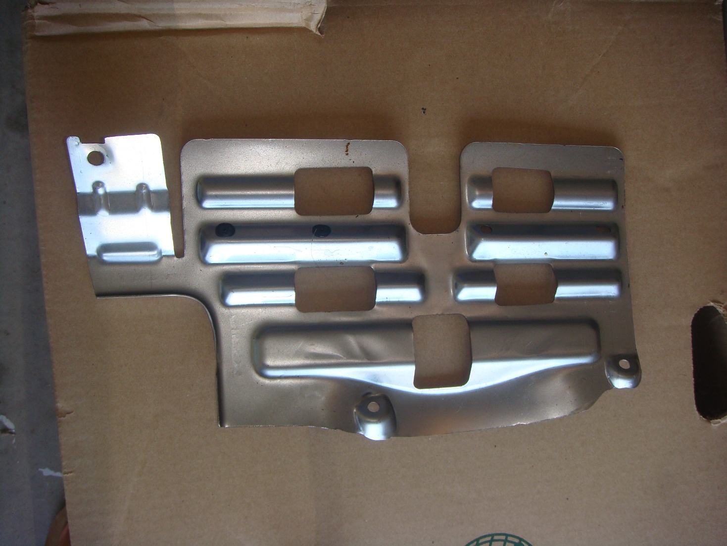

So earlier this week, I'm driving down a bumpy gravel road and suddently I get this loud buzzing sound from under my dash! I feel around as I'm driving and realize it's coming from the under dash panel just below the steering wheel. Today, I removed the panel to see what was causing all of the noise and found this metal panel half-attached to the plastic dash panel. Unfortunately, the only thing holding this metal plate to the plastic panel are about six plastic mushroomed heads (no screws!)...mine only had 2 left, the other 4 or so had broken off. I just removed the plate, but my next questions is, is it important? The only thing I can think of is that it's there to provide structural support, from what I don't know (your knees maybe?). It looks like a heat deflector of some sort, but there's nothing there generating heat. I figure if it were important GM would have made the attachments sturdier, as it is now you can't reattach it, you have to buy the the entire panel with the plate already attached. On the other hand, why would they even bother attaching this thing if it weren't important? It's pretty sizable too, nearly 1'x1' and weighs a pound or two.

Its part of the knee bolster and needs to be replaced. It is part of the structure of the dash in case of an accident. Your vehicle is under warranty so get it fixed.
I saw that thing when I pulled the bottom part of my dash panel off. I don't see how a metal panel attached, barely, to a plastic panel is going to save you in an accident, or do anything.

That's what I was thinking. I doubt it could really help that much. I figure if I've hit anything with enough velocity that the dash is going to come all the way back and hit me, then it's been a head-on collision and I've probably got more serious injuries to deal with. Though I've been in an accident in a little 2wd nissan pickup where both my knees and my wife's knees went through the dash. Her's actually went through the entire glovebox. Luckily neither of our legs were injured because of it.
So this is a warrantied item and the dealers will replace it? If so, might as well take care of it properly.
