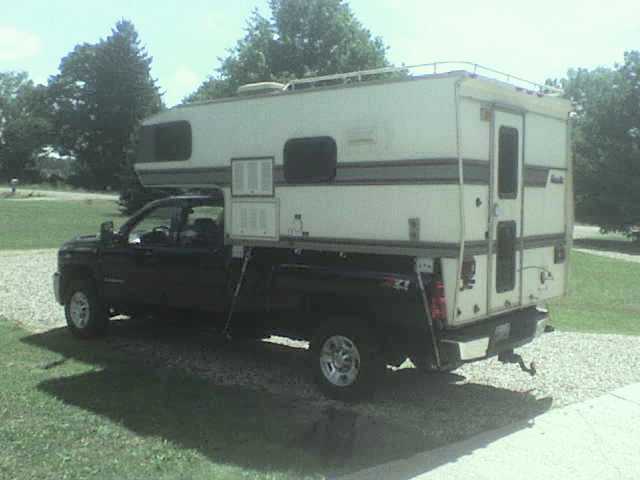

I can not help you well , but to give you an idea : I have a camper weight loaded (water, food etc..) is around 2200, I carry it with my silverado extended cab 1500 6,0L, I added torklift tie down and rear firestone ride rite. The truck run well, smooth, stable, and brakes very well, the mpg loaded is around 14 according at the roads profile.
