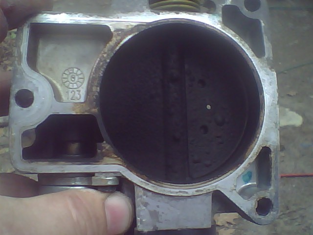

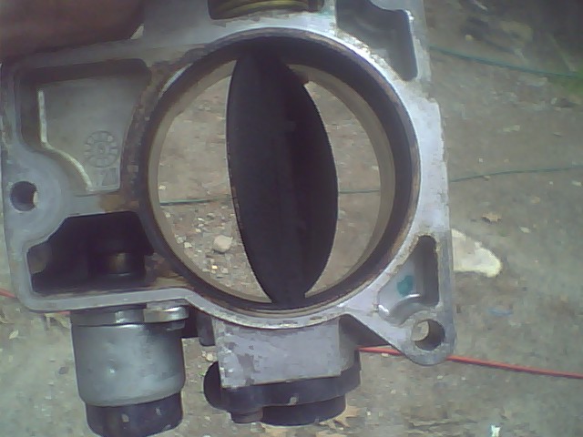

I did a little work on my 97 GMC last weekend. With 135,000 miles, I thought I would give it some induction maintenance. I pulled the Mass Airflow Sensor and cleaned it with CRC MAF cleaner. Super easy job. Then I pulled the Throttle Body and cleaned it, along with the Idle Air Control. TB came off in just a few minutes. Two Torx screws for the IAC, two more for the Throttle Position Sensor. Took the TPS off so I wouldn't have to worry about damaging it with excess TB Cleaner. Sprayed some TB cleaner on the TB and used an old toothbrush and scrubbed it down. Cleaned the bore, throttle plate, and IAC port. Took a couple of passes, but it cleaned up very nicely. Gave the IAC a couple of quick squirts. Put everything back together, truck started right up. I reused the TB to intake gasket. Once she was running and warmed back up, I pulled the brake booster vacuum line. Poured a bottle of Sea Foam in very slowly (use a funnel). Had some pretty nasty crap coming out of the tailpipe. Put another can of Sea Foam in the tank. I have since run that tank down and filled back up.
After
