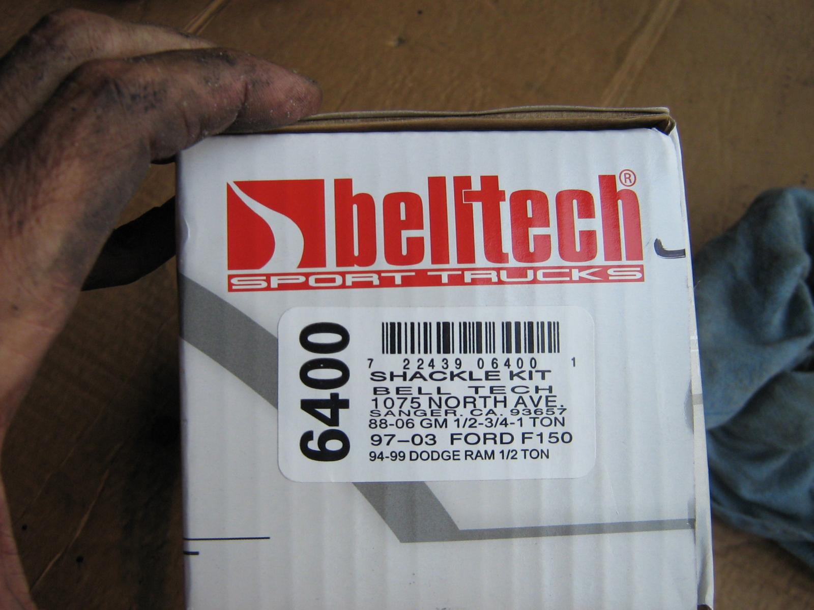

Grab some belltech drop shackles...I installed them on my truck and it has worked just fine for the last 2 years or so.

Sometimes you have to use Chevy Silverado instead of GMC. BellTech is a #6400 for CC.

and i guess am going to have to go with belltech i have heard good about them
Thanks I have coil springs and shocks. And the pics of ur set up really help Monday am going to order my set
