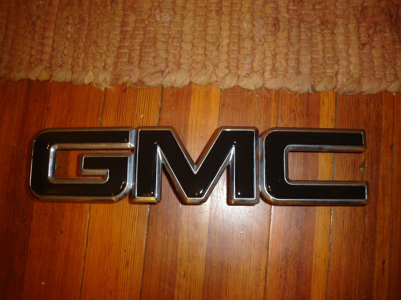

If sk1er18 hadn't posted that picture I would have never dreamed that this badge came out so easily. When I FIRST wanted to get rid of it, I assumed it was all part of the grill. I was worried about painting it in the grill, having to mask it off with that big cumbersome grill getting in the way...after seeing his photo above, I went out and just felt around until I found the tabs. It popped right out, I cleaned it up, put masking tape over the whole face, used a utility knife blade to trace the ridge where the red and chrome surround meet, scuffed it up with some sandpaper, cleaned it, primed, painted, cleared and less than 24 hours later it's done, and it was basically free. It isn't PERFECT but it's good enough for this truck. I'm letting it cure a bit longer indoors but I'll put it back in tomorrow and grab another shot of it back in the grill.
