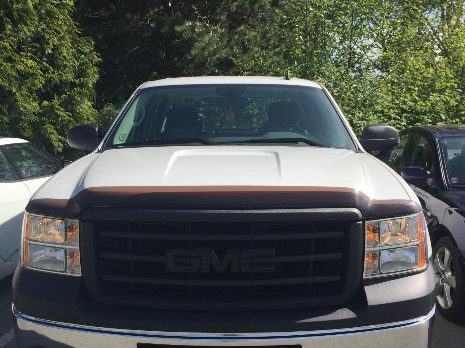

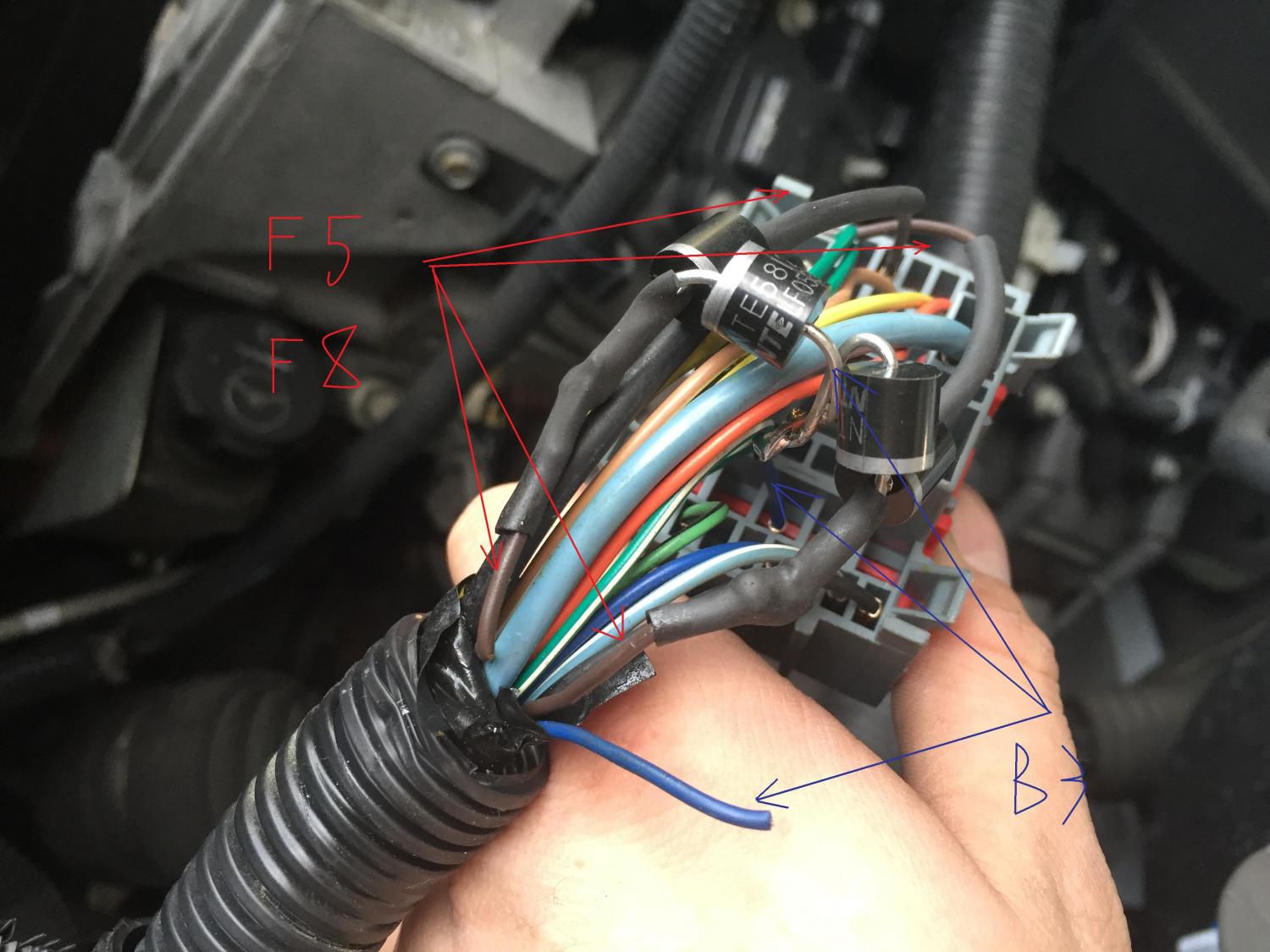

So I just did this on the weekend, really happy with how it turned out. i wanted my parking lights (ambers in the middle) to be my DRL instead of my low beams but didnt want to just pull fuse 31 and 33 and risk forgetting to turn my exterior light switch to parking lamps and get a ticket (im in canada and legally have to have light on all the time) so i used the instructions posted by a42887
this is how i wired it up before i taped it all up
truck is on and in drive with no fuses pulled

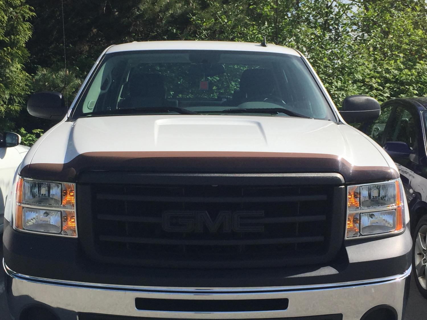

have to do another post reached file size limit
continuation of above post
this is with the turn signal on to show it lights up brighter

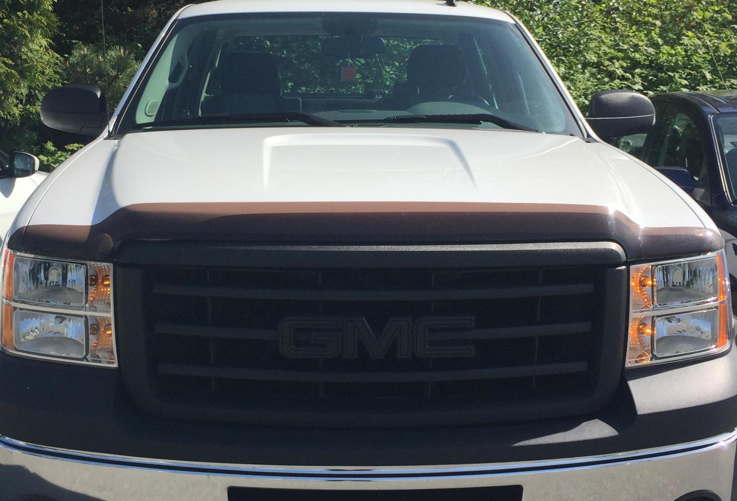

truck in drive with light sensor on dash covered (low beams still automatically come on in dark)
didnt notice any difference in the tail lights but being in canada they are always on while in drive
