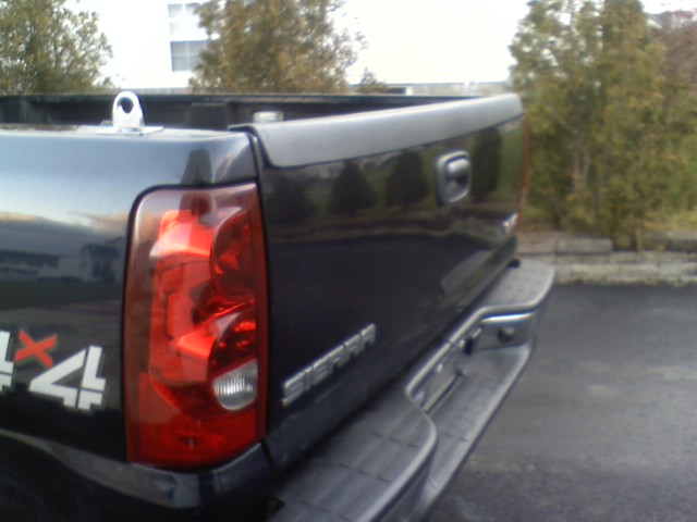

Here is a pics of 04' tails on my Truck,
Thanks for the link 99Heartbeat, looks like an easy enough swap and if I can score a harness at the right price I'll have hit gold. I may actually have most of the parts to build my own anyways as I have a couple tail harnesses from a Cavalier and something else around the yard.
