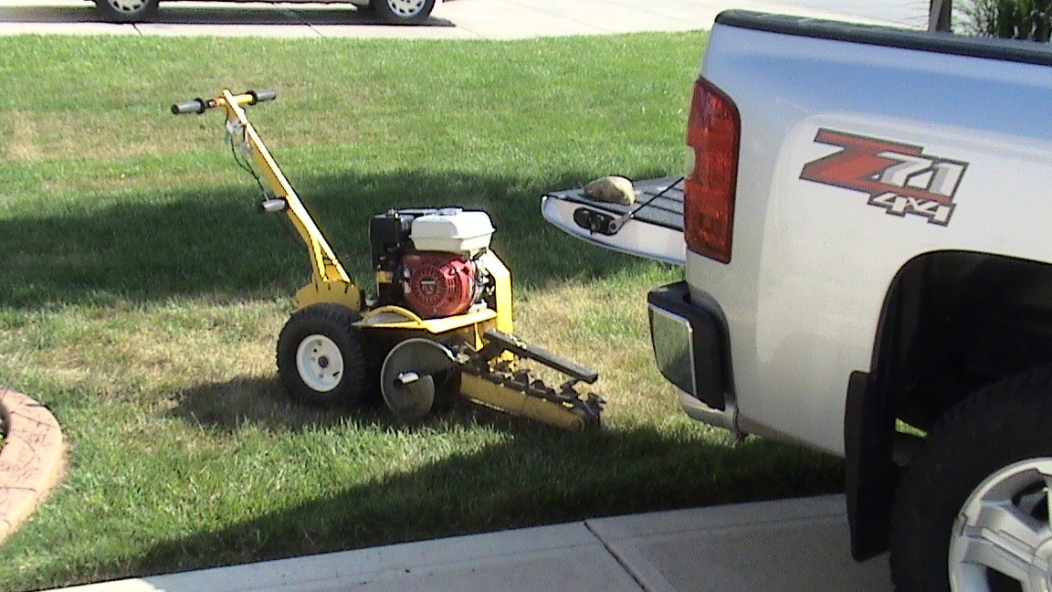

I had this beast on the tailgate. It was around 350lbs. No issues except it was a struggle to get it out of the bed between my neighbor and myself.
