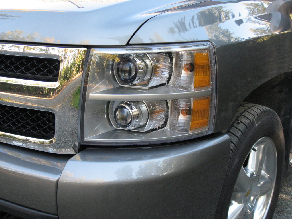

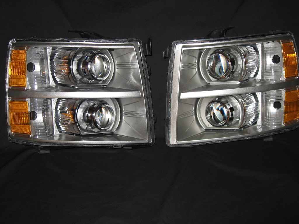

How does this look?
This is all courtesy of Matt @ www.theretrofitsource.com
I have been fascinated with true factory HID set-ups for many years, but like many members here have absolute hatred for the idiots that just install a bulb and cheap ballast in their rides and say look at my HIDs. I can say pretty confidentally that there are way more crappy set-ups out there than factory ones. For those of you in doubt, please lower yourself (just once, we don't want to make a habit of this) to check this out for yourself at a high end car dealership (Lexus, Honda S2000, Mercedes, etc). These lights look nothing like the light clouds running down your local street lighting up everything BUT the road in front of them while blinding on-coming drivers.
Just a heads up for those who do not know..... HIDs (High Intensity Discharge) lights are not aimed any higher than traditional Halogen lights. They are actually aimed lower on the driver's side of the vehicle. The cut-off line is very sharp, unlike traditional Halogen bulbs. Low beams have a "gate" that is either permanent or on a solenoid (depending on whether it is a 2 lamp or 4 lamp set-up) to make sure low beam is low beam. This gate and focusing device is called a projector. Looks kind of like a geek's Coke bottle lenses on his glasses. These types of set-ups do not use the silver reflective surface on a traditional light assembly. Think of a mini camera in your light housing with the light only coming out of that little lens. When a idiot takes the bulb and wiring from that set-up and puts it in a traditional lamp housing the light hits the silver reflective surface and with no guard (for the low beam) it makes a very bright lighting mess. Want an example? Take a spot light and shine it directly into a mirror!!
When done right (it is still a modification), these lights are far better to anything else on the market.
