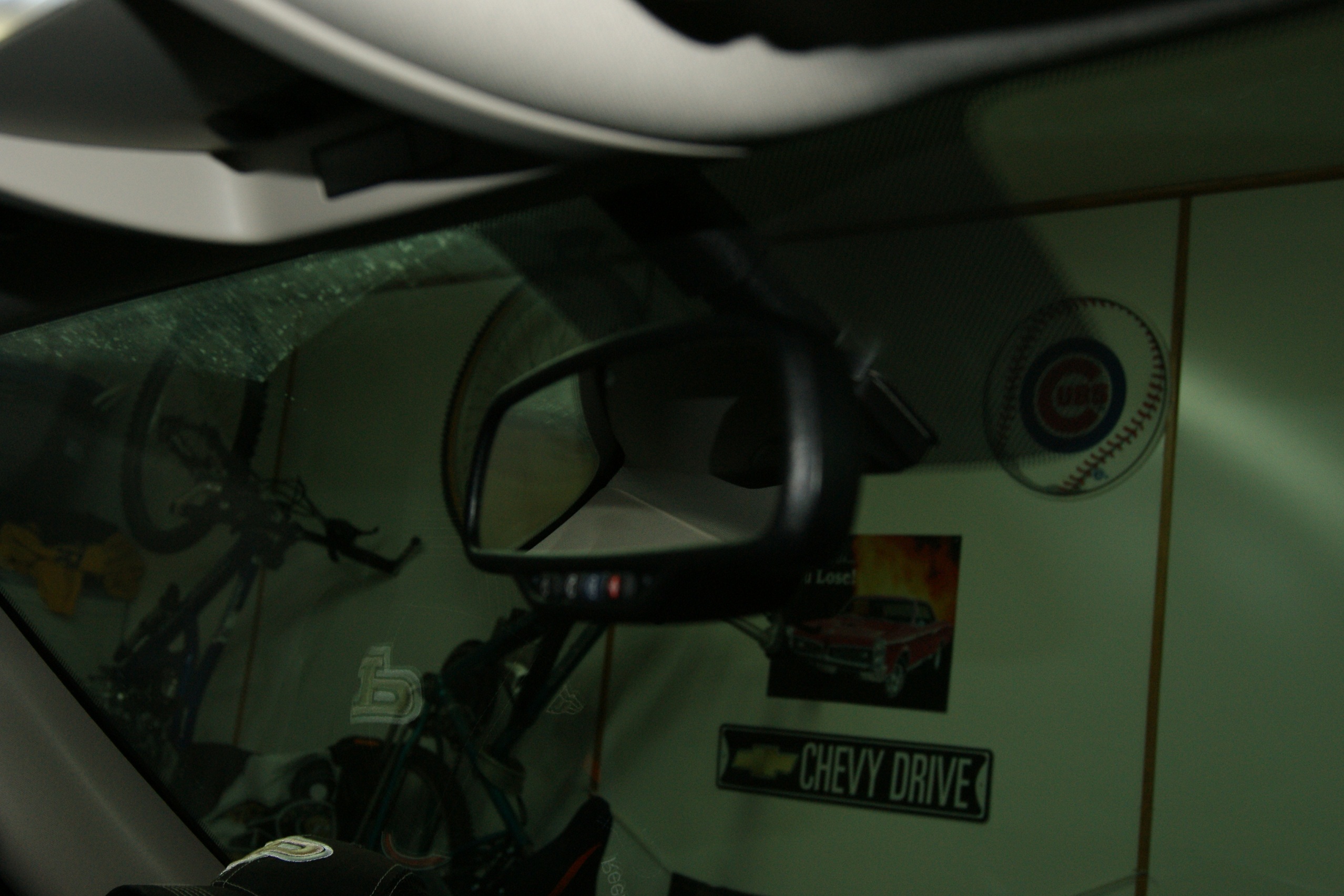

I received the auto dim mirror through ebay, gm part 15816792. Installed last week. Plug and play, basically you have to loosen the torx screw (photo 1) and disconnect the wire harness from behind the mirror. Remove the mirror and pop the wire harness into the new mirror and attached to window then re-tighten torx screw. 5 min max to replace. It is much better than the manual mirror and I hated the hanger at the bottom of the mirror, it acts as an obstruction.

I cant answer the onstar question as I no longer have a subscription (I dont see why it wont work). Bluetooth was unaffected.
