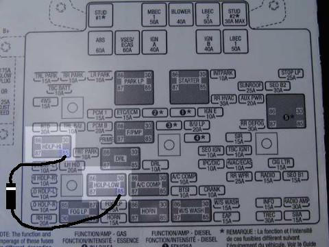

Yep it is a headlight mod. It will keep the low beams on while the high beams are on.For 99-02 you just need to tap into the yellow wire on each headlight and ground it. For 03-06 there is a different method however, it involves a diode in the fuse box.
03-06 mod with diode..

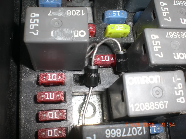

Anyone have a picture of what this looks like on the truck when completed? Im looking for what the fuse box looks like, not the headlights. :shakehead:
Also, what kind of diode do I need, and what a common place to get it?
I believe it is a 3 amp 50 volt diode. And here is a picture form another site. Also I think you would be fine with inspection considering most new GM vehicles operate like this from factory.
