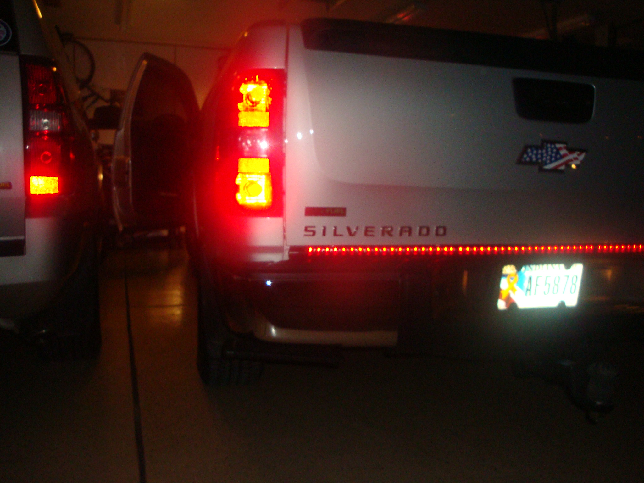

1st pic is with the truck running, it acts like the taillights and stays red

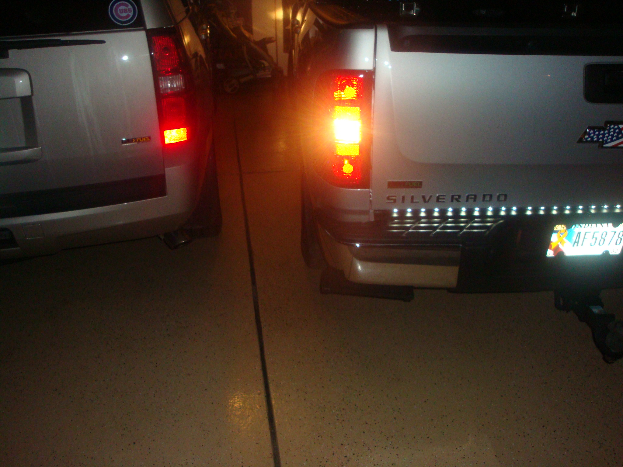

2nd pic is with truck off white lights like the reverse lights
This also does a blinking amber turn signal and white when you are in reverse. With the emergency lights they blink red.

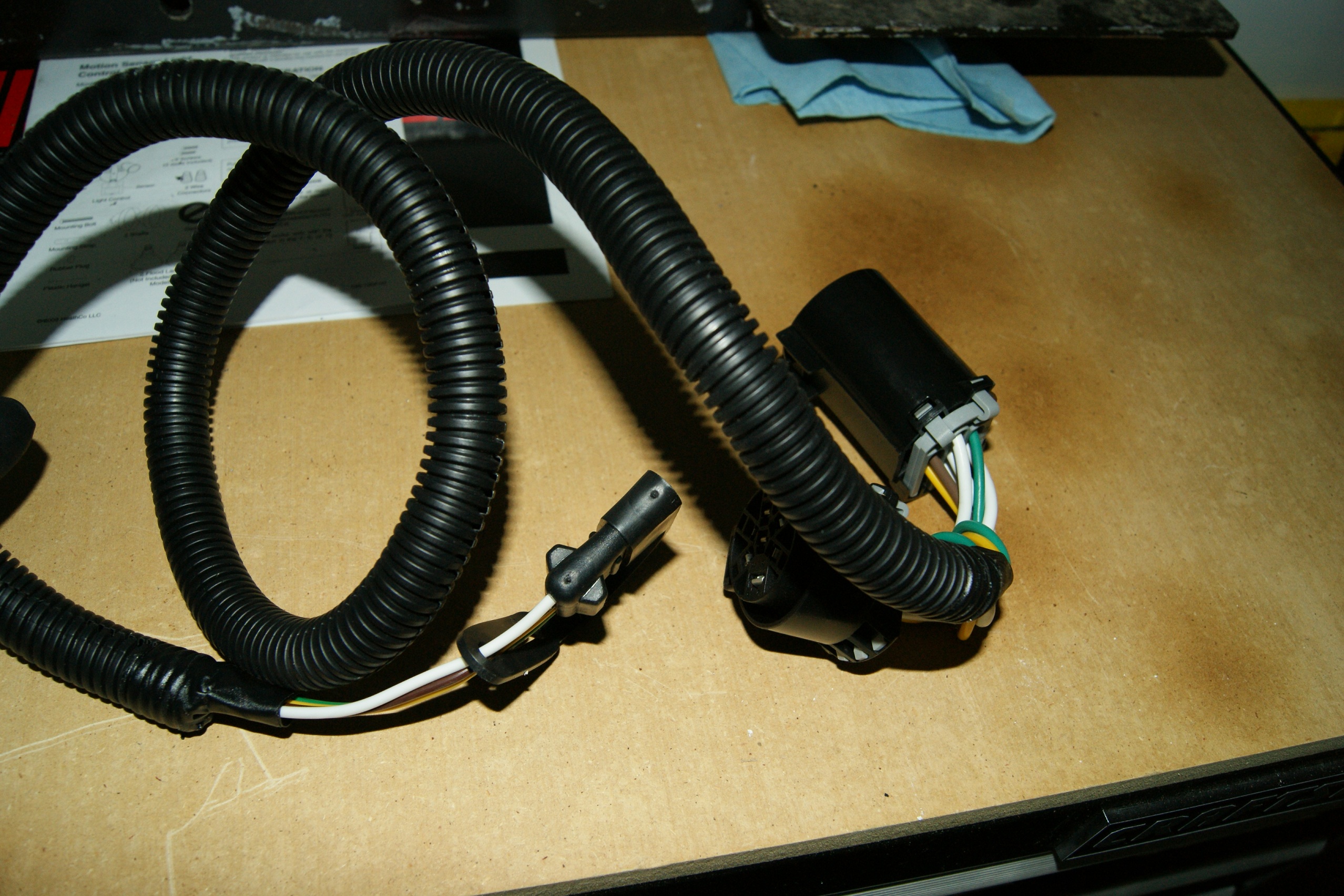

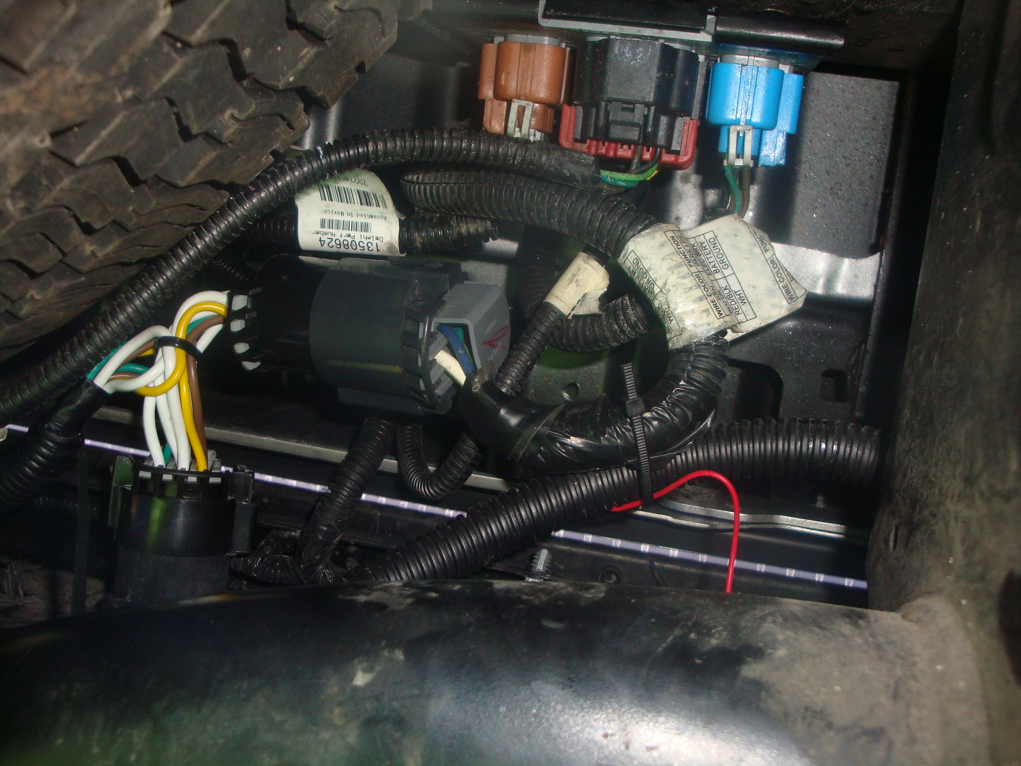

I used the Curt adapter to add a 4 pin adapter (see attached photos) and I hardwired the power (red wire) and reverse lights (white wire)
How much did this run you if you don't mind my asking?
$109 for the light bar and $24 for the adapter from realtruck.com
